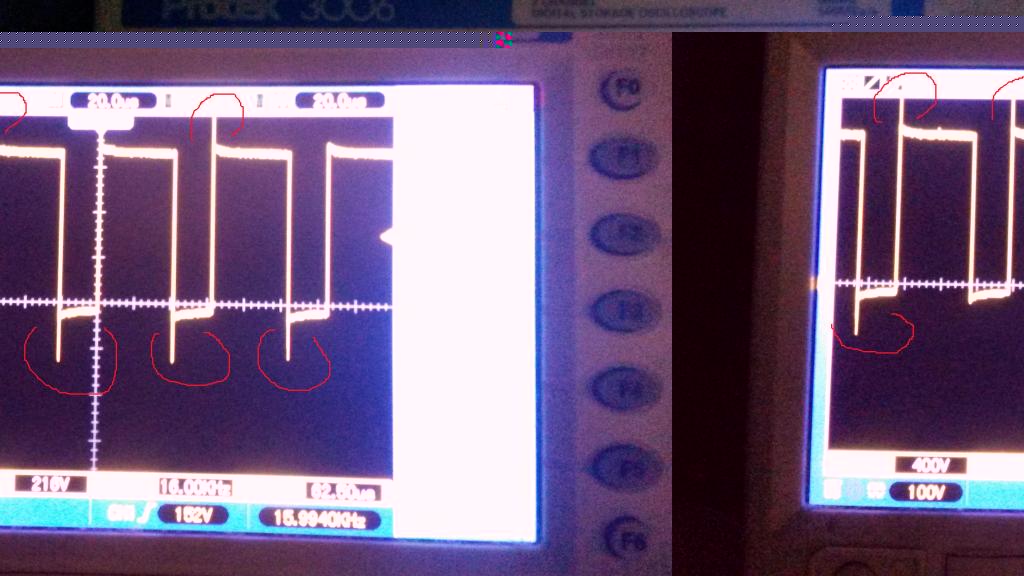

Content originally posted in LPCWare by LabRat on Mon Oct 20 08:37:27 MST 2014
Quote: Lukman_Bawafi
What could be improved?
Calibrate it....

Content originally posted in LPCWare by Lukman_Bawafi on Mon Oct 20 07:26:21 MST 2014
Hello
I create a project using LPCXpresso LPC1115 Rev A.
I utilize SPI to read 16KHz WAV files from the MicroSD, then channeled through the voice data out PWM signal. The problem is, the sound is not clean because of the interference noise, after I see in osciloscop pwm signal produced is not good. signal can be seen in the picture at attachment. What could be improved?

Content originally posted in LPCWare by NXP_Paul on Mon Oct 20 06:14:07 MST 2014
Hello Lukman
Since this is a new topic, unrelated to the LPC1114 ISP, in the future, please start a new topic when the subject is changed.
Unfortunately, I don't understand your question.  Are you questioning a disturbance of the PWM signal caused by the resetting of the TC?
Please provide more detail regarding the problem you are experiencing.

Content originally posted in LPCWare by Lukman_Bawafi on Mon Oct 20 04:41:32 MST 2014
Hello
I create a project player wav file using 16KHz PWM, the source files from microSD. The sound was out but no disturbing noise (hum). Pwm signal when I look at osciloskop no disturbance during the process of resetting the TC (timer counter). How do I solve this?
RC filter already exists.
Lukman
