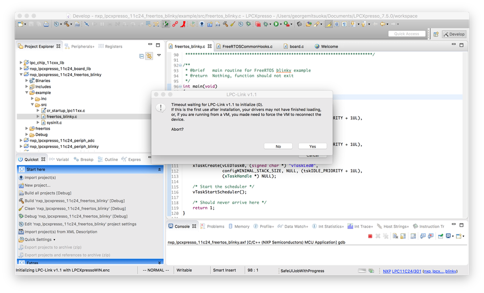

I am running LPCXpresso 7.5.0 on Mac OS X 10.11.6 and using the stock nxp_lpcxpresso_11c24_freertos_blinky code on an unmodified LPCXpresso LPC11C24 REV B card. I have used this setup many times in the past for large projects as well as with different code bases and different processors and boards.
After installing 8.2.0, trying to debug and finding the problem previously mentioned, I have found that 7.5.0 no longer works reliably.  When starting a debugging session, the debugger times out waiting for the LPC-Link to initialize:
In addition, it appears that once an LPC-Link board has been used on my system with either 8.2.0 or 7.5.0 the board becomes unusable on other older installations (tested with 3 different LPC-Links and on a separate computer with 7.7.2 that has not had a later (post 7.7.2) installation. It times out on that system as well.
Through much trial and error, I've found that if I power cycle the LPC-Link, start a debugging cycle with 8.2.0 and then switch to 7.5.0 without power cycling the LPC-Link, it works. I can also power cycle the LPC-Link and run the following command line from the 8.2.0 bin directory:
./dfu-util -d 0x471:0xdf55 -c 0 -t 2048 -R -D LPCXpressoWIN.enc
I can then run 7.5.0 and the LPC-Link works.

The original LPC-Link (aka LPC-Link1) does not contain any built-in firmware. It is soft loaded by the LPCXpresso IDE the first time you start a debug session after power up. The firmware that is soft loaded is not guaranteed to work with any other IDE version than the one that soft loaded. This has been the case since LPC-Link1 was introduced 7 years ago,
But it has particularly been the case over the last year or so due to changes in the LPC-Link1 firmware triggered by Apple's rewrite of the Mac OS USB stack - which has caused similar problems for the vendors of many USB devices.
Thus if you are switching between IDE version, you should always power cycle your LPC-Link1.

George, we are investigating your earlier problem report. The problem you're reporting here sounds like a driver issue, but it doesn't make sense to me. The LPCXpresso_8.2.0_647 installation has an updated libusb dynamic library, but the particular libusb version used is local to each installation. If you rename the LPCXpressoWIN.enc firmware file in your LPCXpresso_7.5.0 installation to, say, LPCXpressoWIN.enc.bak and copy over the LPCXpressoWIN.enc file from the LPCXpresso_8.2.0 installation, does LPCXpresso_7.5.0 behave as you expect?
El Capitan introduced a new USB device implementation, but it unfortunately broke several legacy drivers. The updated libusb distributed with LPCXpresso_8.2.0_647 works around problems introduced with El Capitan, and it also has updated LPCXpressoWIN firmware.

Okay, this make sense. It's likely the El Capitan USB issue, I hadn't considered that and it's possible (likely) I upgraded to El Capitan since the last time I was using 7.5.0. Moving a board to a Windows PC running 7.1.1 works.
I tried copying LPCXpressoWIN.enc from the 8.2.0 installation to the 7.5.0 installation but that does not fix the issue. I also tried copying libusb-1.0.0.dylib from the 8.2.0 installation but l can see by using ls -lu that it doesn't appear to get loaded when the IDE runs. I rebooted my Mac and it still doesn't appear to get loaded. Is there a way to patch 7.5.0 so that it uses the new usb library?
