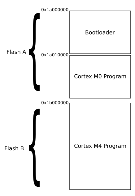

I have problem with debugging M4 program if M0 program is before M4. It's look like this:
Bootloader run M4 program from Flash B then M4 run M0 Program from Flash A.
Debugging M4 program in this configuration is impossible. It's look like debugger try run Cortex M0 as M4 program.

If M0 program is after M4 program then everything works well.
How to debug M4 program in this configuration as above?

lpcxpresso_supp
Do you download the bootloader along with the application code? If so, you could modify the LPC18LPC43InternalFlashBootResetScript.scp to provide the bootloader entry as the initial PC, then deal with stopping execution in the M4 code. Doing this might make sense if the application relies on something in your bootloader setup, but it's somewhat messy to do. If you don't download the bootloader with the application (the more common case), then modify the script PC setting to use the M4 entry, not the M0 entry as it appears now.

klatecki
thank you for quick reply.
I dont' download the bootloader with the application.
I added this line to the script:
101 a% = peek32 this 0x1b000004
and its works!
Thank you a lot!
