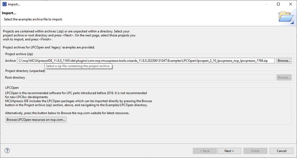

Correct. This is because for LPC1769, there's no SDK. Instead, development support for LPC1769 is based on LPCOpen framework which is integrated into MCUXpresso IDE.
Screenshot MCUXpresso IDE 11.8.0:
In a later step select the appropriate LPCOpen archive:
10,485 Views
hennep

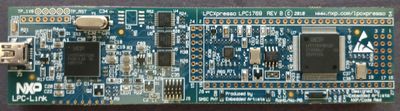

It took me a while to get that all up and running. I did not expect dependencies between projects.
One problem still. I cannot find my board. It is probably a really old one.
10,466 Views

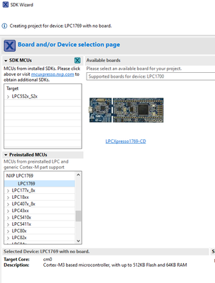

Why not try to create a project based on this one:
I think the major difference is the debug probe on the board.
10,460 Views
hennep

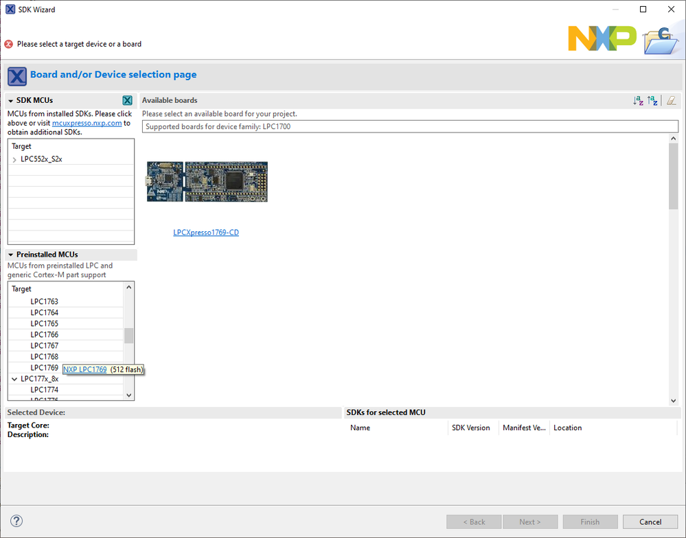

It is not available in my IDE
10,457 Views
danielholala
Senior Contributor II
So which IDE are you using? Does the screenshot show the "Create a new C/C++ project" wizard that's offered in the Quickstart Panel?
Do not use the link "Import SDK example(s)" from the Quickstart Panel.

hennep
Thanks again Daniel,
I did use the wrong dialog. In the meanwhile I can create a project for the LPC1769 that compiles ok.

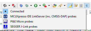

@hennep , I think I've never used the "Run" button. I rather use either the "Debug" link from Quickstart Panel or the button for the "GUI Flash Tool", see screenshot:

hennep
It's hard to unlearn habits. I've used the run button in Eclipse in both Android app development and in STM32Cube but I will get used to it.
It all works, the fun part starts right now
