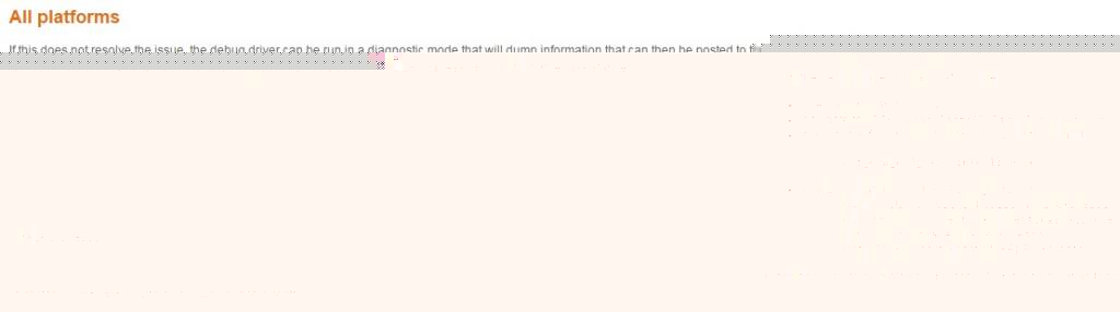

I tried everything is told in this page: https://www.lpcware.com/content/faq/lpcxpresso/flash-image-too-large
When I tried debug driver in diagnostic mode, I received following message:
C:\nxp\LPCXpresso_8.1.2_603\lpcxpresso\bin>crt_emu_cm3_nxp -info-license
Ni: LPCXpresso Debug Driver v8.1 (Mar  4 2016 17:16:07 - crt_emu_cm3_nxp build 327)
Cr:f LPCXpresso Free License - Download limit is 8K (UNREGISTERED)
Then I decided to write her further assistance.
