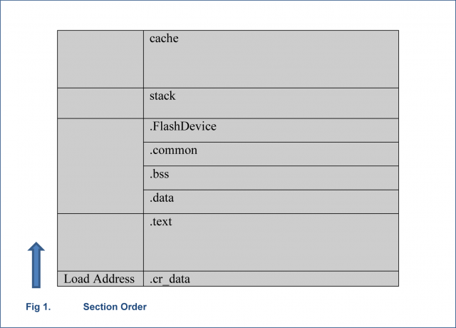

A custom linker script, FlashDriver.ld, is used for the final driver image. An example script is provided in the SPIFI flash driver example project. It’s critical the FlashDriver.ld section order be maintained in the link for the final driver image. Be certain to exclude code/data contributed from the test harness configuration. If your driver implementation creates custom named sections, the section order must not supersede the FlashDriver.ld section order. The final driver image should be ordered as follows, from the RAM Load address:
Figure 1 - Section Order
Flash driver files ready for deployment testing, or deployment should be named with a .cfx file extension, and placed in the Flash subdirectory in the LPCXpresso IDE installation (see below). There are two configuration parameters in the FlashDriver.ld linker script which reserve space for the flash driver stack, and image cache you may need to modify. These are:

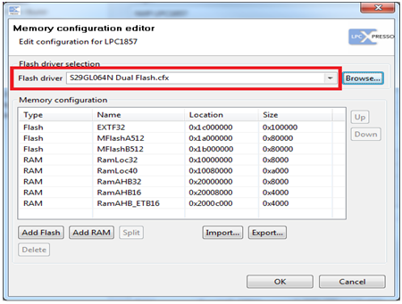

Once the .cfx file has been added, the project to be flashed needs to be modified in order to use the new flash driver file. First, the new memory configuration (External Flash) needs to be added to the MCU selected. This can be done by selecting the C/C++ Build->MCU settings (in the Project Properties window) and clicking Edit and adding the memory as shown in Figure 2. Note the Location and Size columns in the Memory configuration editor should match the exported FlashDevice DevAdr and szDev fields.
Fig 2. Memory configuration editor
The same dialog box (shown in Figure 2) can be used to add the name of the flash driver file (e.g. S29GL064N_Dual_Flash.cfx). The window appears as shown above.

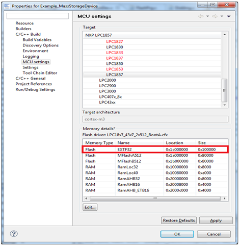

Fig 3. Region
Once these changes are complete, a sample application should be built to locate in the added memory region. The binary file is programmed into the Flash memory by clicking on the Program Flash button, shown in Figure 3, and selecting the corresponding .axf file, as shown in Figure 4. This will program the flash memory using your new flash device. The board needs to be reset after this.

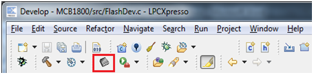

Fig 4. Program Flash Icon

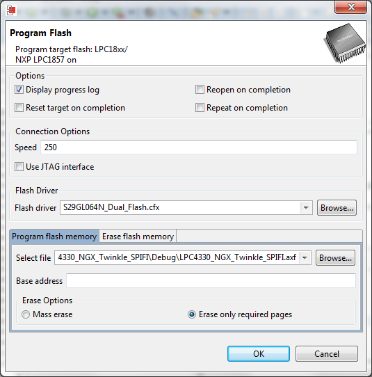

Fig 5. Flash Dialog
As a debug aid, you can check the “Display progress log” box to view the console output from the erase/program operation. The debug utility can be also
used standalone from the command-line (DOS command window). An example command-line will be displayed in the progress log. You should navigate to
