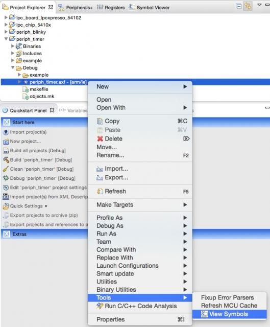

To open an image in the Symbol Viewer, either highlight it in the Project Explorer Views and use the context sensitive menu 'Tools->View Symbols' menu, or use the Browse button on the Toolbar within the Symbo Viewer windows itself
The Symbol Viewer can display object files (.o), libraries (.lib) and executables (.axf or .elf)

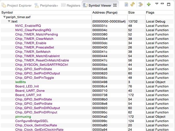

The image will be processed and displayed in the Symbol Viewer as seen below:
It is possible to open multiple Symbol Viewers by pressing the 'Green +' icon in the toolbar. The symbols for different images can then be displayed simultaneously.
Using the Symbol Viewer
When first opening a file, the viewer will display the sections found in the file (e.g. .text, .bss etc). Expanding a section will show the symbols within that section. Clicking on the symbol name will open the source file in an editor window. at the symbol definition (if appropriate).
The columns of the symbol viewer show information about the symbols:
  • Symbol Name
  • Address: The address (or value) of the Symbol
  • Size: The size of the symbol, in bytes. For functions this would be the size of the function. For variables, this would be the size occupied by the variable
  • Flags: The type of the Symbol. Typically this would be Local or Global and Function or Object (data variable)
