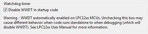

In order to avoid this problem, the LPCXpresso IDE's LPC12xx project wizard allows your project to be created such that the startup code for your application will also disable the WWDT:
This means that application behavior will then be the same under debug and when running out of flash from reset.
If at some point, you want to prevent the startup code from disabling the WWDT, then you can do this by simply deleting the symbol __DISABLE_WATCHDOG from the compiler options.
