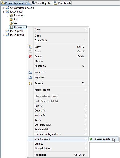

When a new static library project is created, a file called liblinks.xml will be created in the top level of the library project. If you right click on this file within the Project Explorer View, you can then select:
Smart update -> Smart update
which will run the smart update wizard. This will pop up a dialog box listing all the projects in the current workspace. Simply tick those projects that you want to link to this particular static library project.
