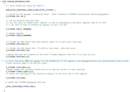

So here How I tried to implement the timer interrupt.
the Ctimer0_intialize() is called in the main.  I was just testing everything out so probably you do not need to do same steps of initialization. and I set random value for timer interrupt.
CTIMER_Type is a struct that hold timer registers. it already exist in LPC54628.h
the timer interrupt handler, I used the same Name in Startup file. and this function is written before the main function. or define its prototype inside a header that is included in the main. all what this interrupt_handler do is toggle an LED ON and off.

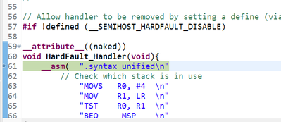

If timer interrupt occur and you did not correctly define a handler with the same Name, it goes to the default handler which is HardFault_Handler();

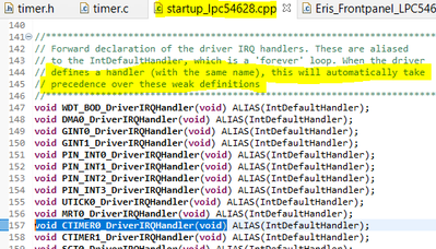

so, the following is from Startup.
if you using sdk and included timer files. these file might already have CTIMER0_DriverIRQHandler() defined there, so be aware of declaring CTIMER0_DriverIRQHandler again without removing it from the already existed file.

I think you did not fully grasp the idea behind the handling of interrupt handler names in most Cortex M toolchains.
As you might know, the core uses a table with a list of all interrupt vectors specified for this specific MCU, starting with the reset vector. All offsets into this table are fixed for a specific MCU, with the first dozen (roughly) fixed for all MCUs (defined by ARM).
Since the MCU starts from the reset handler, it was choosen to define the entire vector table, and initial settings for all entries (or some of them). Often default handlers that do nothing but a while (1) loop. Those functions are defined as WEAK, a method that allows the linker to deal with two symbols of the same name. Actual names depend on the toolchain, and might differ from one to another.
And yes, for using a peripheral and it's interrupts, you are supposed to use exactly the name as defined in the startup file / vector table. And not declaring your function as WEAK gives it precedence over the default function. This happens at link time, no need to change the vector (handler address) at runtime using __NVIC_SetVector().

Have you checked the SCB registers for the cause of the hardfault ?
https://www.keil.com/appnotes/files/apnt209.pdf
