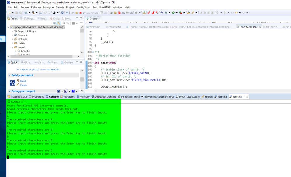

hai
when i try to enter some value in serial port that time my entered value doesn't print in the serial as well as o/p also not coming   please let me know the solution
In below i attached my error snaps please find the attachments below
Thanks & Regards
Aravind P

Hello Aravind P,
In this board, the Micro USB port(J3) only can send character, can't receive, because only the UART_TX connect to it.
So when run this demo, please connect the UART to your PC using TTL to USB.
In this demo,  USART0_TXD connect to P0_7     USART0_RXD connect to P0_18 .
I test on my side ,it can work well:
Hope it helps,
TIC
