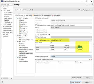

Hello @ErichStyger
Just follow Erich's suggestion, you can change to MCUXpresso Style in Properties of your project, then can change the size of Heap and Stack, As below:
Alice
10,678 Views
ekellmyer
Hello Alice,
I applied your suggestion and changed the project Heap and Stack placement to MCUXpresso style. While using 0.00% Heap and 2.34% stack, I still did not see any printed characters in the console.

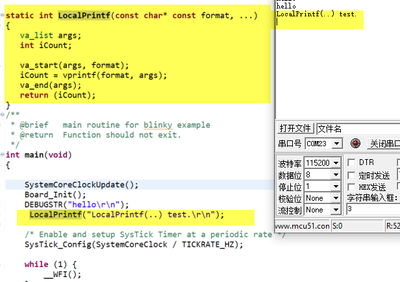

Hello @ekellmyer
How about have a look at below thread, there is a demo about vprintf:
https://community.nxp.com/t5/LPCXpresso-IDE/LpcXpresso-and-Redlib-vprintf-problems/m-p/549214
Alice
10,547 Views
ekellmyer
I have seen this post previously, and it looks like this is an LPCXpresso issue rather than an MCUXpresso issue. LPCXpresso is no longer supported, and I'm not sure what exactly the agreed upon solution was to the post.
10,501 Views

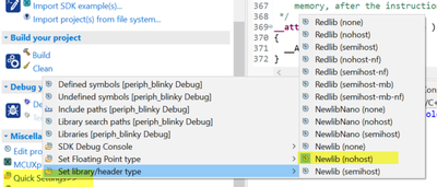

Hello @ekellmyer
Please choose Newlib(nohost) as below:
I test on my side, it can work well:
Alice
10,466 Views
ekellmyer
I changed my library to Newlib nohost with no success. In the image you provided, it looks like you redirected the output to a terminal over UART. My goal is to display the text in the console view in MCUXpresso.

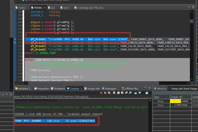

ekellmyer
When using Newlib(semihost) and MCUXpresso Style Heap and Stack Placement, I am able to get out a single debug message to the console. vprintf() returns -1, indicating an error occurred, and all messages after the first one do not appear in the console. Any thoughts on this?
10,464 Views
ekellmyer
I did not initially notice this, but the last word of the vprintf() statement is printed twice.
vprintf() returns -1 and all subsequent print statements do not show in the console.
10,454 Views
ekellmyer
Further testing has shown that the print statement is appending the last 5 characters in the string to the end of the string... Not sure what is going on here... It also looks like the spacing between size and 31 is too large for what is specified in the string.

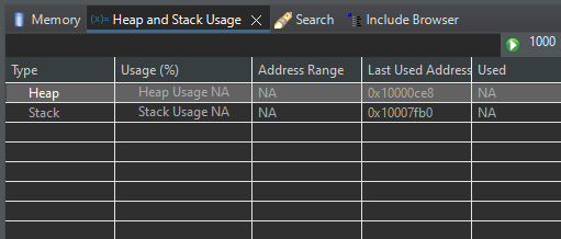

There is a lot of things behind printf(), and depending on your re-targeting it to stdio it will need a lot of stack and heap space. Have you checked that you are not running into buffer overflows, stack overflows and heap overflow? Best if you try it with plenty (>8 KByte) of heap and plenty of MSP Stack (>4 KByte).
Check it with the Heap and Stack Usage, see https://mcuoneclipse.com/2023/01/29/arm-swo-itm-console-bidirectional-standard-i-o-retargeting/
10,790 Views
ekellmyer
Thank you for such a quick response. I just checked the heap and stack usage and found them both to be NA. Sounds like I'm missing something in my project settings perhaps?
10,787 Views
