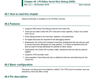

can i connect directly the jtag pins to the gpio pins of the lpc54628 chip, is the muxed pins of gpio for swd is only for the swd connection or for both and so swd only has three and swd has five. please help me as soon as possible.

xiangjun_rong
Hi, Suraj,
Pls refer to the Chapter 49: LPC546xx Serial Wire Debug (SWD) in UM10912.pdf, the SWD interface is used to download/debug, the JTAG interface is used only for boundary scan function for LPC546xx family.
I copy it from UM10912.pdf.
In conclusion, You have to connect the SWD signals to connector.
Hope it can help you
XiangJun Rong
