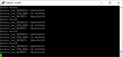

Yes, I created a small example project to show what is working and what is nt working as expected.
this is what I did:
  • I took the hello world example as basis
  • I splitted the RAM (SRAM) memory, to have a very small section for my noinit at the very end:
    • RAM (SRAM): address: 0x20000000, size: 0xFFF8
    • RAM4 (SRAM_NOINIT): address: 0x2000FFF8, size: 0x8
  • I created a noinit section in this new memory area in the loader file:
/* NOINIT section for SRAM_NOINIT */
.noinit_RAM4 (NOLOAD) : ALIGN(4)
   PROVIDE(__start_noinit_RAM4 = .) ;
   PROVIDE(__start_noinit_SRAM_NOINIT = .) ;
   *(.noinit.$RAM4)
   *(.noinit.$SRAM_NOINIT)
   *(.noinit.$RAM4.*)
   *(.noinit.$SRAM_NOINIT.*)
   . = ALIGN(4) ;
   PROVIDE(__end_noinit_RAM4 = .) ;
   PROVIDE(__end_noinit_SRAM_NOINIT = .) ;
} > SRAM_NOINIT AT> SRAM_NOINIT
  • I created 3 noinit variables, using macro's from cr_section_macros.h:
    1. This is the preferred variable, added at the very beginning of the normal SRAM memory
__NOINIT_DEF uint32_t noinit_var_DEFAULT
2. This variable is placed in the USB_RAM memory.
    Because we want to use USB in our application, this is not a workable solution for us.
__NOINIT(USB_RAM) uint32_t noinit_var_USB_RAM;
3. This one will end up in the new memory area, at very end of the normal SRAM
__NOINIT(SRAM_NOINIT) uint32_t noinit_var_NOINIT;
  • I enabled the USB FS0 Device clock (needed for USB RAM) in clock_config:
CLOCK_EnableUsbfs0DeviceClock(kCLOCK_UsbfsSrcFro, CLOCK_GetFroHfFreq());​
  • After the hello world message over UART I show the value of the 3 noinit variables:
PRINTF("noinit_var_DEFAULT: 0x%08x\r\n", noinit_var_DEFAULT);
PRINTF("noinit_var_USB_RAM: 0x%08x\r\n", noinit_var_USB_RAM);
PRINTF("noinit_var_NOINIT:  0x%08x\r\n", noinit_var_NOINIT);
  • And then I increase each variable by 1:
noinit_var_DEFAULT++;
noinit_var_USB_RAM++;
noinit_var_NOINIT++;​
My expected results are:
  • At powerup each variable will have 'random' values
  • After a software reset (without a power cycle), each variable will be increased by one
But this is the result:
  • The variables in USB_RAM and my new SRAM_NOINIT area are increased by 1 on reset: OK
  • The preferred variable noinit_var_DEFAULT stays the same: NOK
    Actually also after a power cycle this variable remains the same
I attached my example project.
Thanks in advance for your help!
BR, Jan Pieter de Ruiter

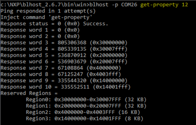

8,715件の閲覧回数
Hello
The ROM reserved regions can be obtained from the blhost command "get-property 12".
Alice
8,711件の閲覧回数
janpieterderuit
Hi Alice,
thanks for the info.
So I tried the blhost tool.
I first used the version shipped with MCUXpresso (C:\NXP\MCUXpressoIDE_11.4.1_6260\ide\binaries).
I wasn't able to connect at first, but as soon as I did a chip erase, I was able to connect to the LPC55S16 on my dev board.
But I get the following response:
C:\NXP\MCUXpressoIDE_11.4.1_6260\ide\binaries>blhost -p COM10 get-property 12
Ping responded in 1 attempt(s)
Inject command 'get-property'
Error: read_start_byte() timeout after 5.152 seconds
sendCommandGetResponse.writePacket error 5.
Response status = 10004 (0x2714) No response packet from target device.
But I noticed the blhost vresion in MCUXpresso is 2.6.5, while you screenshot shows v2.6.7.
So I looked blhost up on the NXP site, and found the latest version here:
https://www.nxp.com/design/software/development-software/mcuxpresso-software-and-tools-/mcu-bootload...
But I get the same response:
C:\NXP\blhost_2.6.7\bin\win>blhost -p COM10 get-property 12
Error: read_start_byte() timeout after 5.167 seconds
I also get the same response with other properties (e.g. 1 (The current version of the MCU bootloader))

Hello janpieterderuit,
Does your chip enter ISP mode?
If no, please check UM to enter ISP mode, then can use blhost.
Alice
8,674件の閲覧回数
janpieterderuit
Yes, it does enter ISP mode:
  • As it's fully erased, it will always go to ISP mode with Auto ISP.
    Also when I hold the ISP pin low on power-up, I get the same result
  • blhost reports "Ping responded in 1 attempt(s)", so I suppose that means that initial UART ISP communication (including baudrate determination) is OK.
