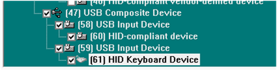

For example, keyscan got 'b', and use USB_DeviceHidSend() to send HID packet,
but the PC continue to receive 'bbbbbbbb' for thousand times.
device[59] send 'b' report packet once, but device[61] continue to send.

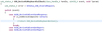

I have commented the USB_DeviceHidKeyboardAction() in  function USB_DeviceHidKeyboardCallback().

I know the answer now, need to release the key.
