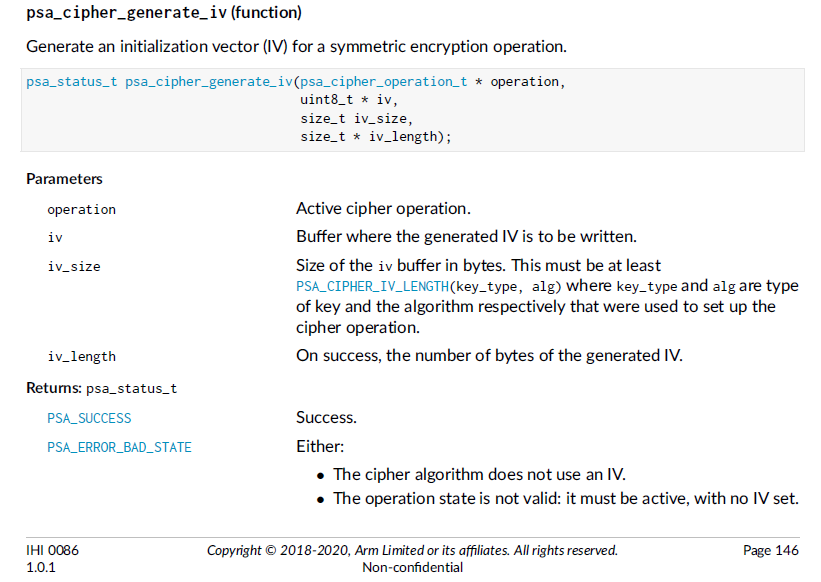

About encrypt a data using the following API on LPC55S69.
  • psa_cipher_generate_iv
  • psa_cipher_update
  • psa_cipher_finish
The following macro definition is defined in the API specification. https://developer.arm.com/documentation/ihi0086/latest/
  • PSA_CIPHER_IV_LENGTH
  • PSA_CIPHER_UPDATE_OUTPUT_SIZE
  • PSA_CIPHER_UPDATE_OUTPUT_MAX_SIZE
  • PSA_CIPHER_FINISH_OUTPUT_SIZE
  • PSA_CIPHER_FINISH_OUTPUT_MAX_SIZE
I have mbedtls enabled and tried to build the SDK, but crypto_sizes.h doesn't have these macro definitions.
Why is no define?

Hi Shinji,
According to the same document you are referring those macros were added in 1.0 beta 3 version. You can see this in the C.1.2 Changes between 1.0 beta 3 and 1.0.0 section of the document.
Our latest SDK is using Platform Security Architecture APIs Version 1.0 so these new macros are still not reflected in our drivers.
