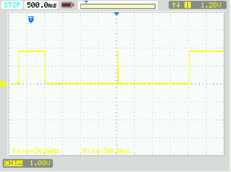

The above code will get two times 2Seconds.
We can check the LED2 pin, this is the oscilloscope wave about the LED2 pin in MCB1857:
This is the printf data after just reset:
Begin1 begin1 Downcounter=6a3 ; PresetCount=800; enable=0
Downcounter=69e ; PresetCount=800; enable=0
Downcounter=0 ; PresetCount=0; enable=0
Downcounter=0 ; PresetCount=800; enable=0
 End1begin2 Downcounter=7fd ; PresetCount=800; enable=0
Downcounter=7f9 ; PresetCount=800; enable=0
 End2 ========================================

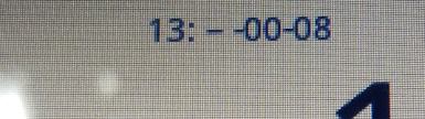

billsheng
Hi Kerry,
Thanks for your efforts on this issue.
The headache problem we had that RTC module could not work as expected.
You could see following picture on the real device.
We made following work around.
               Chip_Clock_RTCEnable();
                for (waitMS = 0; waitMS < 2000; waitMS++)
                LPC_RTC->CCR = value | (1uL << 4); // Disable calibration
                if ((LPC_RTC->CCR & 0x1FuL) == (value | (1uL << 4)))
                                LPC_RTC->CALIBRATION = 0;      // Disable calibration
                                return(true); // Leave if it is done
                            _BusyWaitMicroSeconds(1000uL); // Wait 1 millisecond
From the testing, the leave time after RTC ready is around 1700ms.
We tested on the failed 5pcs MCU samples, which found RTC not work problem, it could fix the issue.
But it's ugly that we have to disable calibration always in the loop.
We tested that move this disable calibration after delay 3.2 seconds, RTC could not work either.
It's appreciated that NXP could help us confirm the work around would not cause other problem.
