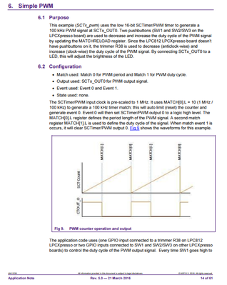

Hi all,
I have a question about the AN11538 app note. can you tell me why at hte beginning of chapter 6.2 seems to use the  MATCH register and then in the code of chapter 6.3 it uses the MATCHREL registers? What are the differences between MATCH and MATCHREL?

Hi @Miguel04
Ok I see. But why in the configuration code of the app note it does not initialize the MATCH registers? Don't you skip the first iteration of the counter in this way?

Hi @topspin
Yes apparently the appnote skips the first iteration of the counter, however on the user manual is not specified that both registers have to be configured simultaneously.
I hope this answers your questions.

Hi @topspin
MATCH and MATCHREL are 2 different registers, you can find the information on the user manual (f.e. LPC82x\'s UM10800) chapter 16.6.1.3 Match and capture registers
"The SCT includes a set of registers to store the SCT’s match or capture values. Each
match register is associated with a match reload register which automatically reloads the
match register at the beginning of each counter cycle."
