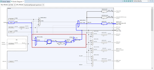

Hello All,
I am wondering if there is a reference utility pll calculator I can use.
Basically I have a board which has 25Mhz external crystal and I want to have the system clock to be 96 Mhz.
Can some one guide me as to PLL register settings I can use.

Hello ,
Hope you are doing well.
I'd recommend to use the clock config tool. Here you have a user friendly diagram which will help you configure the PLL accordingly. It also provides warnings when exceeding the limits of multiplier and divider. I attempted to get a 96 MHz system clock from 25 MHz input and got close but not exactly.
For more details on how to use the clock config tool, please review the Config Tool user guide.

This is perfect. Thanks Sabina.
