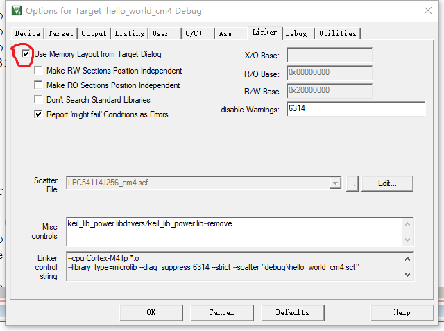

   The compilation environment I am using is keil5. First, I need to first download the Bootloader program and the first version of the APP program. The two programs download Flash at different addresses. The Bootloader program is stored in 0X0~0X8000. The first version of the APP program is stored in 0X8000~0X20000. So I checked this option (as shown) to download the two programs to different addresses.

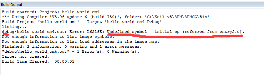

If you do not change the startup file, you will be prompted with the following error (as shown). So I changed the startup file to eliminate this error.
   The changed startup file can upgrade the M4 core, but it affects the startup of the M0 core. I have changed the startup file and its effects and errors, I said in the post. I hope to solve this problem, not a jump problem. I can upgrade the LPC1768 or LPC54114M4 core, but I can't upgrade the LPC54114 dual core.
