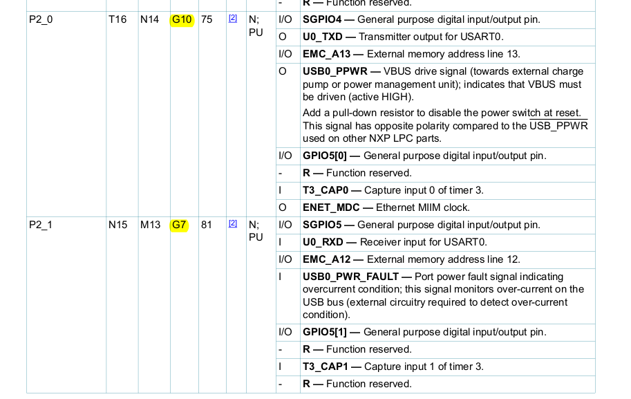

i_am_chenkc
Hi Kerry,
I had checked the Pins P2_0(U0_TXD) and P2_1(U0_RXD) from the lpc4330 Xplorer board schematic (om13027).
The P2_0 is already used by Ethernet ENET_MDC and the P2_1 is used by USB0_PWR_FAULT.
Is it possible to use the USART3 for the UART ISP ?
Thx, Eric.Chen

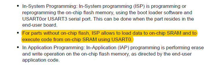

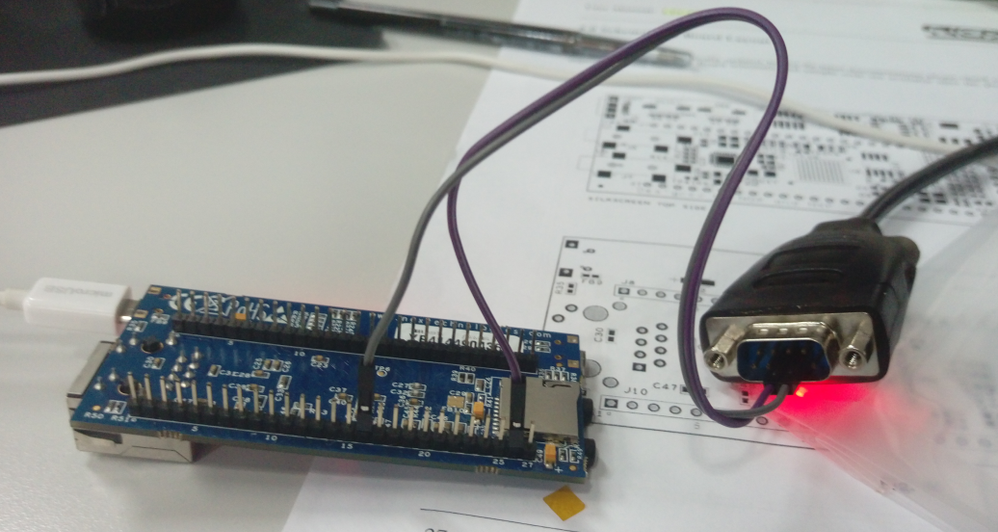

kerryzhou
Hi Eric,
   Please check the user manual:
  Because the chip without on chip flash, then you need to USART0, even the according pin is connect  other component, but you still can connect it to the UART.
  Please follow my step:
1. Connect your USB-UART tool to these pins:
  1) P2_0 is GPIO5[0], it is J10_16. TX pin, connect to your USB-UART tool RX pin.
   2)P2_1 is GPIO5[1], it is J10_26, RX pin, connect to your USB-UART tool TX pin.
 2. Power on the board after you connect the USB-UART pin to your board.
 3. Press RESET and SW2 switch, then release the RESET at first, then release SW2.
 4. open FlashMagic, choose the COM port as the number of your USB-UART, then ISP->Device signature
  You will find the chip is connect to the flashmagic
  This is the picture from my NGX LPC4330 board.
You can try it on your side.
Wish it helps you!
Kerry

i_am_chenkc
Hi Kerry,
Thanks for your detailed information.
I had follow the steps one by one.
But I get the error message "Operation Failed. (reading signature)".
Is there any configuration needed to be done in Flash Magic ?
(ex: menu item  [Options] --> [Advanced options ..] )
1) P2_0 is GPIO5[0], it is J10_16. TX pin, connect to USB-UART tool RX pin_2.
2) P2_1 is GPIO5[1], it is J10_26, RX pin, connect to USB-UART tool TX pin_3.
Eric.Chen
4,774 Views

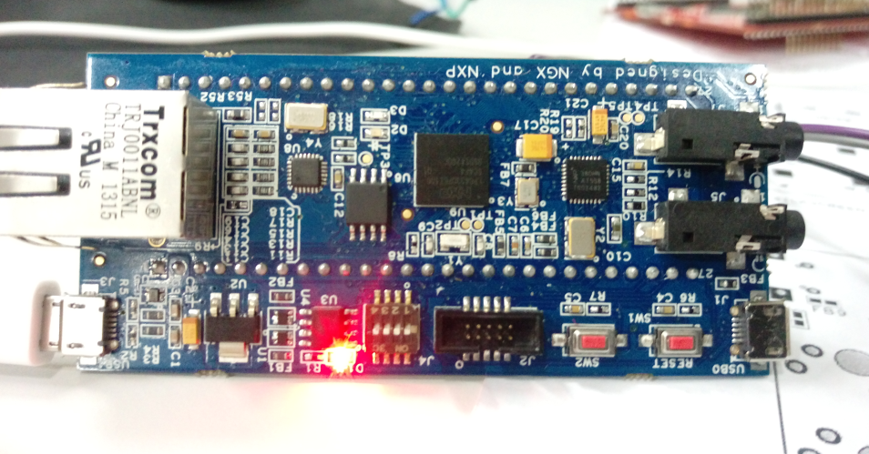

kerryzhou
Hi Eric,
   You didn't connect the GND pin, please also add it.
   Besides, give me another photo of the board top view.
  That's strange, I have test it on my side.
 Before you connect the flash magic, note this point:
Press RESET and SW2 switch, then release the RESET at first, then release SW2., enter ISP mode.
Kerry

i_am_chenkc
Hi Kerry,
The top view as below.
I had connect the GND pin and retry again.
I had follow the steps you describe, press RESET and SW2, then release RESET at first.
and then release SW2.
And this time, I get prompt message "Operation Failed. Failed to autobaud ...."
Thx, Eric.Chen

kerryzhou
Hi Eric,
    You also can try to separate the TX and RX wire, these two wire is bond  together in your side.
    My PC is win 7, but I don't think it is the PC problem. FlashMagic can support win8 system.
    OK, now you can try to use LPCScrypt.
   If you still my help, just let me know!
Kerry

kerryzhou
Hi Eric chen,
    If you don't have the debugger.
   You can use the UART ISP to download the code.
   LPC4330 is the flashless chip, so you just can use UART0.
 Pins P2_0(U0_TXD) and P2_1(U0_RXD) are used for communication with the USART0.
  LOW level after reset on pin P2_7 indicates an external hardware request to start the ISP command handler.
 You can use the MCUXpresso generate the hex file, then use flash magic, with UART ISP to download the code to the SRAM.
You can try it at first, if you still have problem after you test, just let me know!
