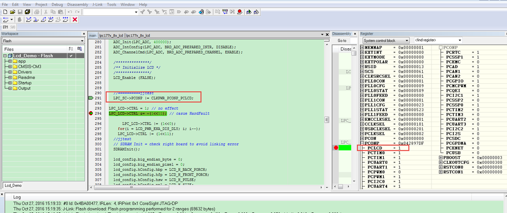

LPC1788FBD208 after set PCONP.PCLCD=1, read LCD_CTRL or other lcd regs cause HardFault,
busfault addr:0x20088018
and write lcd regs no effect, code is below:
int main(void)
LPC_SC->PCONP |= CLKPWR_PCONP_PCLCD;
LPC_LCD->CTRL = 1 // no effect
LPC_LCD->CTRL &= ~(1<<11); // casue HardFault

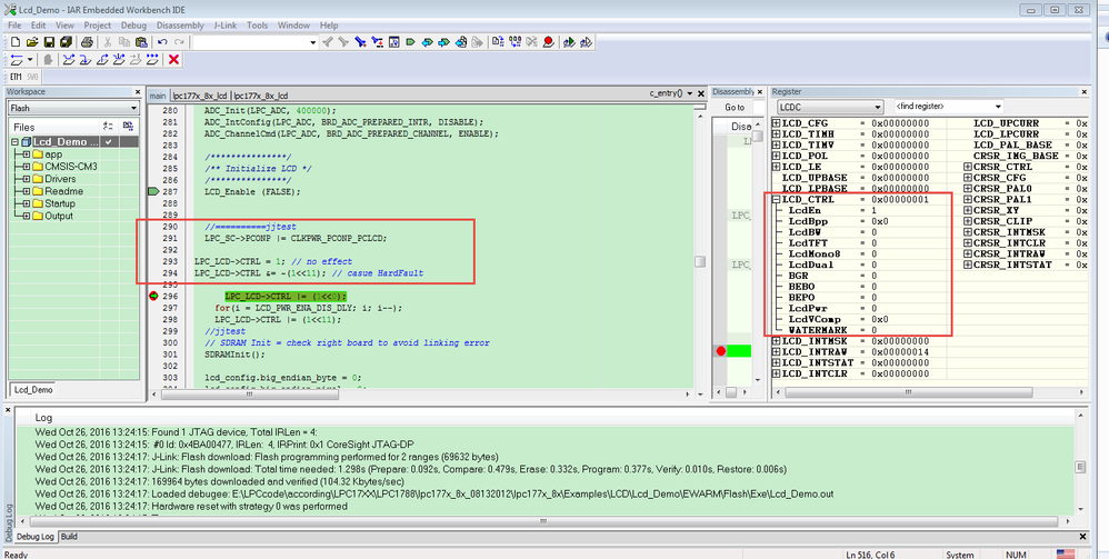

3. I add three line code in LCD_Demo project from NXP package.
change OSC to 24M(my board's config), and change target to lpc1788.
recompile, start debug. error no change.please note LCDC registers in IAR IDE, no value!!!
I think error maybe in my hardware design, but I don't known where.
maybe rtc? reset ?
please check my scheme design.

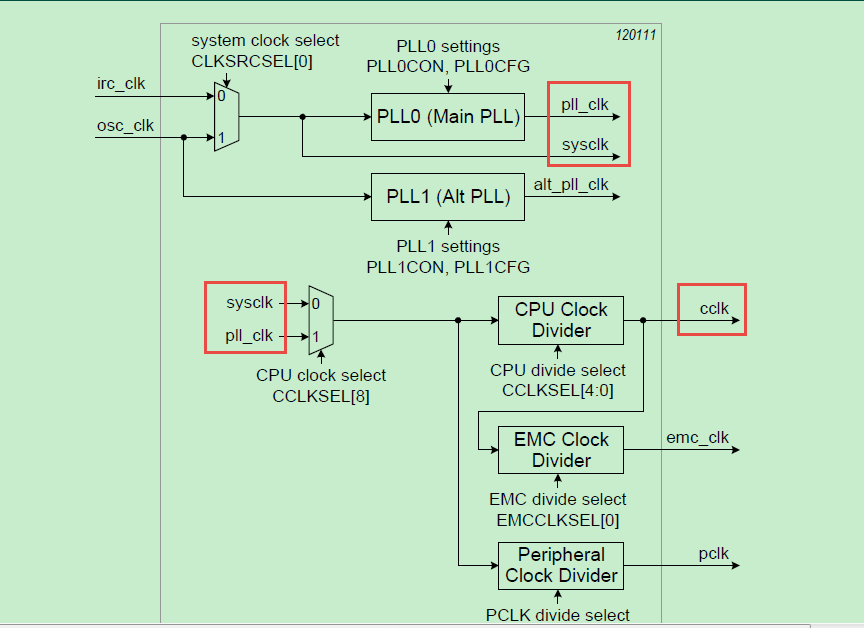

    It seems your LCD module is not powered on or no clock.
   Please check the PCONP->PCLCD regester, did you really open it?
    About the clock, we can get that the default the LCD clock is from CCLK, so please checking yoru configuration, whether the CCLK have clock or not?
Please check these points on your side, if you are using the OSC, please also check your OSC, whether it is oscillating in your hardware.
Kerry

hainie
Hi Zhou !
I think the chip lpc1788FBD208 is the reason , This chip is buy from Tmall ( tmall.com), and maybe is remarked!
Maybe this chip is not really LPC1788, and don't have LCD function.I will buy new chip to test.
And will tell you test result,
Thank you very much!
10,546 Views
kerryzhou
Hi Hai,
    Yes, your problem is really like the LCD module is missing.
   If you buy it in Tmall... the quality can't be guaranteed.
