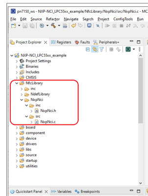

my question can i use this library in any mcu like esp as example if i bought pn7160
or as in example it dependent on LPC family ?

Hello @user_ahmed
Hope you are doing well.
The NFC Reader Library or demos specific to any NFC Frontend from our portfolio could be ported to any other platform; however, porting this software to third-party platforms is out of our support scope and it is up to the customer based on the available resources for PN7160.
Eduardo.
