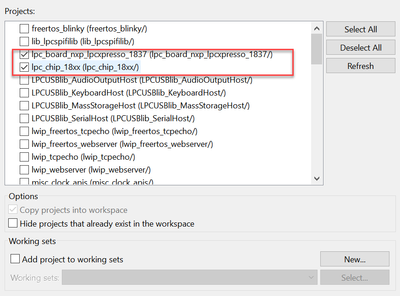

Hello @wade985136 ,
In the following link you can find a list of example to use with the LPC18xx. In this package there's an example called flashIAP that has a list of ROM commands, the reinvoke IAP between them.
You need to also import these projects to your workspace if you want to run these examples:
Alexis Andalon

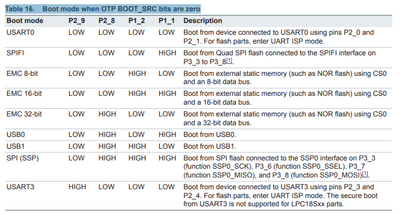

wade985136
Hello, Alexis_A
I tried many times, I still can’t change uart isp to usb isp
Can you help me, how can I modify it?
13,158 Views
Alexis_A
Hello @wade985136,
Please check the Table 16. Boot mode when OTP BOOT_SRC bits are zero, this section mention the state the boot pins need to be to boot from the different available sources:
Alexis Andalon
13,296 Views
