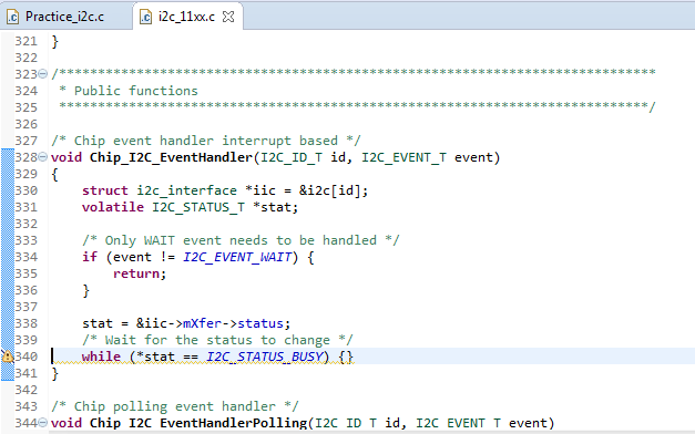

However my setup seems to get stuck here:
Seems that the line stays busy. Osciloscope shows a falling edge on SCA as well as on SCL, when I use debugging mode.

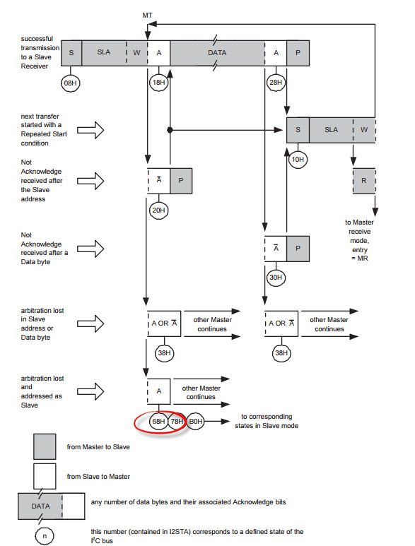

According to LPC11Cxx User Manual (http://www.nxp.com/documents/user_manual/UM10398.pdf?fasp=1&WT_TYPE=Users%20Guides&WT_VENDOR=FREESCA... ) status 0x68 means that Arbitration lost in SLA + R/W as master:
So, it seems that SLA + W bit are being sent and you got an arbitration lost status (another master activity on the bus?).
Have you tried to debug the MasterHandler function?
When you use interrupt driver mode:
/* Set default mode to interrupt */
    i2c_set_mode(id, 0);
IRQ for I2C0 is enabled and inside this ISR, the i2c_state_handling function is called. If you debug further, you will end up at handleMasterXferState function (i2c_11xx.c, line 176) that is in charged to validate transfer status.
