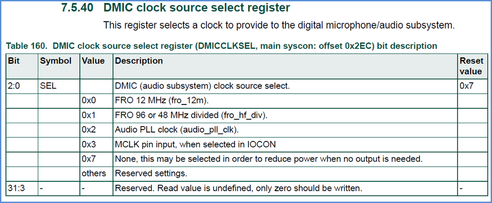

   Im currently working on my new lpc54628,here i completed all the examples given in library.Now my
issue i tried to program on my own using the registers but the IDE is not accepting declarations that im giving to enable a particular register funtions(i.e. DMICCLKSEL_ENABLE).So how to enable a single bit or a complete register and what i have to do?
1,996 Views
ZhangJennie
HI
According to the DMICCLKSEL definition, only last three bits 2:0 are valid bits, see below screenshot. These three bits present different DMIC clock source.  we can set this three bit directly for the different source.
What does DMICCLKSEL_ENABLE mean? what's that for?
