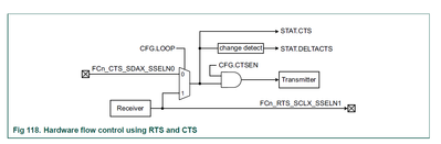

Hi all, is there a way to invert the RTS signal of USART? I have a flexcomm configured as USART, and its RTS_SCL_SSEL signal is configured as RTS, instead of being a GPIO. In my application, I would like to see its output inverted, is there a way for the firmware to do so?

Assume that you use LPC5569, so pls refer to the UM11126.pdf
Pls refer to section 34.7.5.1 Hardware flow control
As the above figure, the RTS signal is an output signal driven by receiver. The RTS is configured to appear on a device pin so that it can be sent to an external device, it indicates to an external device the ability of the receiver to receive more data.
Unfortunately, we have not the code to demo the RTS function.
Hope it can help you

Thanks Xiangjun, the part I am using is LPC54S018JxM, what I am looking for is to invert its polarity via firmware but I cannot find any level of control like this so far.

As I said that we have not the example code to invert the RTS, even the UM does not list the condition to invert the RTS signal.
The usart has receiver FIFO which has 16 entries, I suppose that you can enable the receiver FIFO, and you can receive the data, but you do not read the data from the receiver FIFO and check if the RTS can be inverted driven by the receiver when the FIFO is full.
