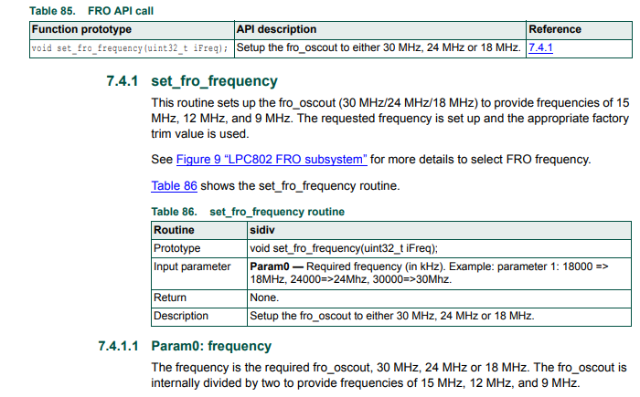

Hi everyone!
I'm using LPC802 in a project, using KEIL. I would like to know how to configure the internal oscillator to 15MHz (max)?. I read the user manual, which says that to configure the internal oscillator to oscillate at the maximum frequency of 15Mhz must use the api directly from the ROM, but I did not succeed, could anyone help me in this configuration?

jerrydurand
Here's my code to set up the FRO.  A few notes:
  • The FRO can only be set to one of a few speeds, see the user manual for more info
  • The system clock is automatically 1/2 of the FRO rate
  • The code below sets it to the max speed for the LPC802
[code]
// set up system clock (the hard way)
asm volatile(                      // the void set_fro_frequency(uint32_t iFreq); API is missing so do this by hand
   " ldr R1, ROM_Tbl \n"    // get address of pointer to ROM Driver Table
   " ldr R1, [R1] \n"             // get pointer to ROM Driver Table
   " add R1, #0x0C \n"       // step down to the entry for the FRO table
   " ldr R1, [R1] \n"             // get address of FRO table
   " add R1, #8 \n"             // step down to third entry in table
   " ldr R1, [R1] \n"             // get address of set_fro_frequency routine
   " ldr R0, FRO_Freq \n"    // put frequency in R0
   " blx R1 \n"                      // call API
   " b Exit \n"                      // done
   " .align 4 \n"                   // fix alignment
   "FRO_Freq: .word 30000 \n" // frequency in kHz
   "ROM_Tbl: .word 0x0F001FF8 \n" // address of ROM Driver Table
   "Exit: \n"                         // end of code segment
SystemCoreClock = 15000000; // System clock is 1/2 of FRO
