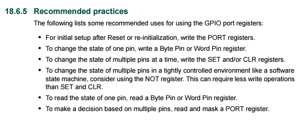

let me know about how to make a gpio to read its pin status for lpc1857

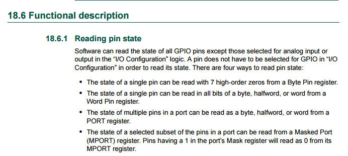

Hi Soledad,
   I have seen this user manual. I am using MDK5. Initially, the pin is configured as gpio input.
GPIO_SetDir(4,11,GPIO_DIR_INPUT); // GPIO direction
SCU_PinConfigure(4,11, SCU_PIN_CFG_INPUT_BUFFER_EN ); //Input buffer enable
if(!(GPIO_PinRead(4,11)))
// do neccessary
but it is always reading the status as 0 even the corresponding pin is in high state.

soledad
Which IDE are you using?
Are you using LPCOpen?
According with the reference manual:
Please check the following thread an let me know if this helps.
