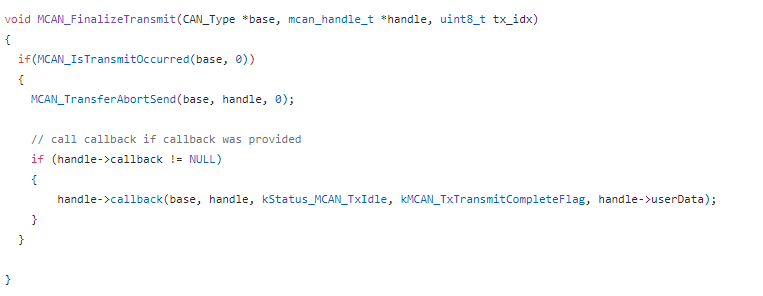

FYI,
We figured something out and that is solving this problem.
We have seen that sometimes the interrupt handler was called with the IR register not set. Probably that are the tx interrupts that we are missing.
We added the following code in the interrupt handler:
The implementation of the MCAN_FinalizeTransmit function is as follows:
To be completely sure we also call MCAN_FinalizeTransmit when an rx interupt occurs.

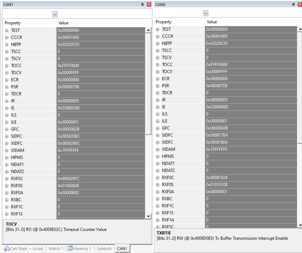

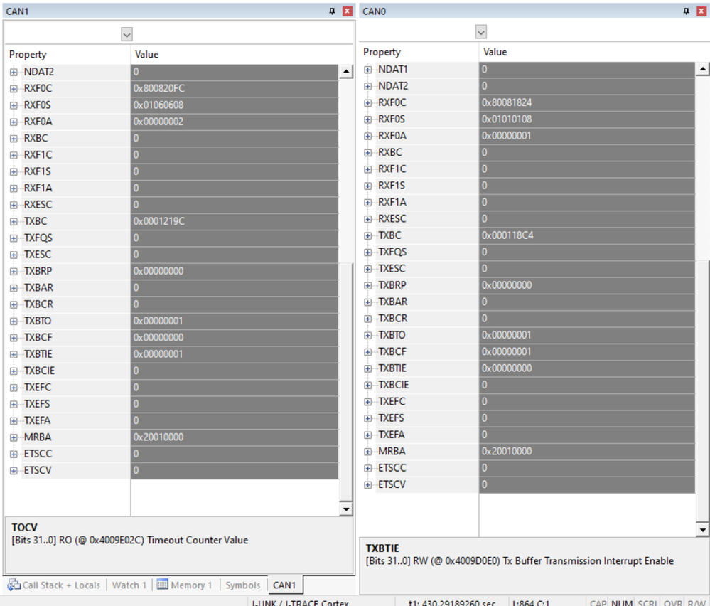

For more information about the register see the screenshots in the appendix / below. CAN1 is the pheripheral with the problems. The screenshots are taken on the moment the problem happend.

Hi Teus,
As I could check in the registers of the CAN1 you have a FIFO with size of eight elements, and is full in the moment in which the error is present. Check the RXF0C and the RXF0S to confirm this information.
So I think something is wrong with the stack you're using. I will suggest to put a watermark in the FIFO and enable the interruption to see when this being filled more that what you want.
