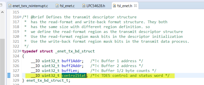

 I'm currently working on LPC54628 board for my ethernt interface. In this my issue is during the configuration i'm unable to declare TDES3 register or OWN bit in keilv5. how to enable the own bit in the program. And other issue is during the transmission i'm only getting the ARP request can't able get the ARP response is there any particular method for this. Kindly help me out of this.

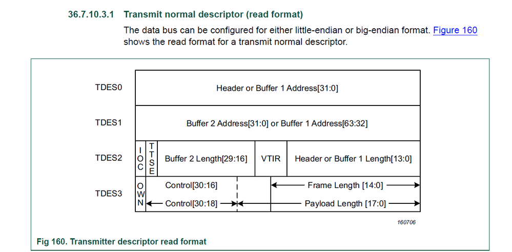

TDES3 is not a register, it is part of Transmitter descriptor:
In SDK driver, you can find the definition from:

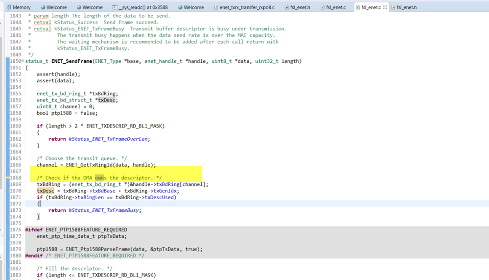

how can i find that the descriptor is owned by DMA or not.

Hello  saidevaraj m ,
Please refer to the code under SDK demo:
