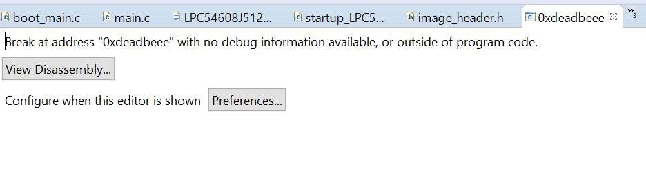

I have gotten past one of my hurdles.  I have a section placement variable to write the single enhanced image enable to 0x24 in FLASH.  At 0x28 I have the pointer to the image header which I stored in .rodata.
The ROM bootloader successfully jumps to my single enhanced image (this will be my secondary bootloader).  My secondary bootloader consumes FLASH space 0x0 to 0x7FFF.  I created a dummy app that blinks LEDS, it consumes FLASH space 0x8000 to 0x7FFFF.  My secondary bootloader, at this moment, simply jumps to my dummy app.
When I flash the dummy app, then flash the secondary bootlaoder all works well (I see blinking LEDS).
However, when I reset I end up in some invalid memory space:
Any thoughts would be greatly appreciated!
PS, I have loaded additional symbol files in the bootloader so I can debug both bootloader and application, so this is likely not a debug issue.
Thanks!
Ben
3,924件の閲覧回数
benmalchow
I resolved my issue.
I had section variables that were overwriting first 7 words starting at FLASH address 0x0.
