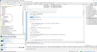

i am using the lpc54s018 development board but in the real board Enet ic changed
currently, it is DP83848IVV/NOPB/LQFP-48 but in development board is having
LAN8720A-CP now how to change  the Enet driver for DP83848IVV if anyone known please reply to me
thanks
best regards
sachin
1,528 Views
xiangjun_rong
I suppose that you need just modify the PHY code, the code for LWIP and Ethernet module is not required to change.

hello sir here what else i need to change here
* Copyright (c) 2016, Freescale Semiconductor, Inc.
* Copyright 2016-2017 NXP
* All rights reserved.
* SPDX-License-Identifier: BSD-3-Clause
#include "fsl_phy.h"
* Definitions
/*! @brief Defines the timeout macro. */
#define PHY_TIMEOUT_COUNT 0xFFFFFFU
* Prototypes
* @brief Get the ENET instance from peripheral base address.
* @Param base ENET peripheral base address.
* @return ENET instance.
extern uint32_t ENET_GetInstance(ENET_Type *base);
* Variables
#if !(defined(FSL_SDK_DISABLE_DRIVER_CLOCK_CONTROL) && FSL_SDK_DISABLE_DRIVER_CLOCK_CONTROL)
/*! @brief Pointers to enet clocks for each instance. */
#if defined(FSL_FEATURE_SOC_ENET_COUNT) && (FSL_FEATURE_SOC_ENET_COUNT > 0)
extern clock_ip_name_t s_enetClock[FSL_FEATURE_SOC_ENET_COUNT];
#elif defined(FSL_FEATURE_SOC_LPC_ENET_COUNT) && (FSL_FEATURE_SOC_LPC_ENET_COUNT > 0)
extern clock_ip_name_t s_enetClock[FSL_FEATURE_SOC_LPC_ENET_COUNT];
#endif
#endif /* FSL_SDK_DISABLE_DRIVER_CLOCK_CONTROL */
* Code
status_t PHY_Init(ENET_Type *base, uint32_t phyAddr, uint32_t srcClock_Hz)
uint32_t reg;
uint32_t idReg = 0;
uint32_t delay = PHY_TIMEOUT_COUNT;
uint32_t instance = ENET_GetInstance(base);
bool status = false;
/* Set SMI first. */
CLOCK_EnableClock(s_enetClock[instance]);
ENET_SetSMI(base, srcClock_Hz, false);
ENET_SetSMI(base);
#endif
/* Initialization after PHY stars to work. */
while ((idReg != PHY_CONTROL_ID1) && (delay != 0))
PHY_Read(base, phyAddr, PHY_ID1_REG, &idReg);
delay--;
if (!delay)
return kStatus_Fail;
/* Reset PHY and wait until completion. */
PHY_Write(base, phyAddr, PHY_BASICCONTROL_REG, PHY_BCTL_RESET_MASK);
do
PHY_Read(base, phyAddr, PHY_BASICCONTROL_REG, &reg);
} while (delay-- && reg & PHY_BCTL_RESET_MASK);
if (!delay)
/* Set the ability. */
PHY_Write(base, phyAddr, PHY_AUTONEG_ADVERTISE_REG, (PHY_ALL_CAPABLE_MASK | 0x1U));
/* Start Auto negotiation and wait until auto negotiation completion */
PHY_Write(base, phyAddr, PHY_BASICCONTROL_REG, (PHY_BCTL_AUTONEG_MASK | PHY_BCTL_RESTART_AUTONEG_MASK));
do
PHY_Read(base, phyAddr, PHY_SEPCIAL_CONTROL_REG, &reg);
delay--;
} while (delay && ((reg & PHY_SPECIALCTL_AUTONEGDONE_MASK) == 0));
if (!delay)
/* Waiting a moment for phy stable. */
for (delay = 0; delay < PHY_TIMEOUT_COUNT; delay++)
__ASM("nop");
PHY_GetLinkStatus(base, phyAddr, &status);
if (status)
break;
return kStatus_Success;
status_t PHY_Write(ENET_Type *base, uint32_t phyAddr, uint32_t phyReg, uint32_t data)
uint32_t counter;
/* Clear the SMI interrupt event. */
ENET_ClearInterruptStatus(base, ENET_EIR_MII_MASK);
/* Starts a SMI write command. */
ENET_StartSMIWrite(base, phyAddr, phyReg, kENET_MiiWriteValidFrame, data);
/* Wait for SMI complete. */
for (counter = PHY_TIMEOUT_COUNT; counter > 0; counter--)
if (ENET_GetInterruptStatus(base) & ENET_EIR_MII_MASK)
break;
/* Check for timeout. */
if (!counter)
return kStatus_PHY_SMIVisitTimeout;
/* Clear MII interrupt event. */
ENET_StartSMIWrite(base, phyAddr, phyReg, data);
while (ENET_IsSMIBusy(base))
#endif
status_t PHY_Read(ENET_Type *base, uint32_t phyAddr, uint32_t phyReg, uint32_t *dataPtr)
assert(dataPtr);
uint32_t counter;
/* Clear the MII interrupt event. */
/* Starts a SMI read command operation. */
ENET_StartSMIRead(base, phyAddr, phyReg, kENET_MiiReadValidFrame);
/* Wait for MII complete. */
break;
if (!counter)
/* Get data from MII register. */
*dataPtr = ENET_ReadSMIData(base);
ENET_StartSMIRead(base, phyAddr, phyReg);
#endif
status_t PHY_GetLinkStatus(ENET_Type *base, uint32_t phyAddr, bool *status)
uint32_t reg;
status_t result = kStatus_Success;
/* Read the basic status register. */
result = PHY_Read(base, phyAddr, PHY_BASICSTATUS_REG, &reg);
if (result == kStatus_Success)
if (reg & PHY_BSTATUS_LINKSTATUS_MASK)
/* link up. */
*status = true;
else
*status = false;
return result;
status_t PHY_GetLinkSpeedDuplex(ENET_Type *base, uint32_t phyAddr, phy_speed_t *speed, phy_duplex_t *duplex)
assert(duplex);
assert(speed);
uint32_t reg;
/* Read the control two register. */
result = PHY_Read(base, phyAddr, PHY_SEPCIAL_CONTROL_REG, &reg);
if (reg & PHY_SPECIALCTL_DUPLEX_MASK)
/* Full duplex. */
*duplex = kPHY_FullDuplex;
else
/* Half duplex. */
*duplex = kPHY_HalfDuplex;
if (reg & PHY_SPECIALCTL_100SPEED_MASK)
/* 100M speed. */
*speed = kPHY_Speed100M;
else
{ /* 10M speed. */
*speed = kPHY_Speed10M;
return result;
