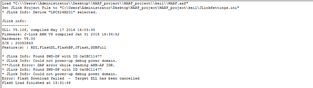

i download with jlink several times then it said that
jink log as follow
how to recovery chip?

caibai
thank you for reply,
but i can't connect device by jlink and error message is
***Jlink Error: DAP error while reading AHB-AP IDR.

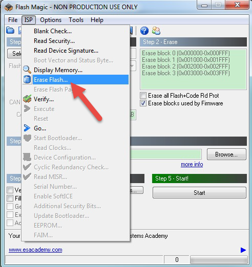

jeremyzhou
Hi cai bai,
Thanks for your reply.
I'd like to know whether the LPC824 can enter the ISP mode or ISP.
If yes, Flash Magic tool supports erase feature which can recover the chip.
Please give it a try.
TIC

caibai
LPC824 can't enter ISP, it can't be use Flash Magic to connect deivce,
now i disable CRC (set value to 0xFFFFFFFF at 0x000002FC) but it also can't to connect after first download image to flash.
