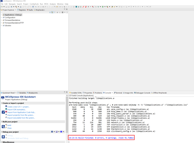

Hi @Charanmakkar_navtech
I checked the
Usage
Download the repository, following the Clone or download button's instructions above.
Import the project into MCUXpresso:
In MCUXpresso create a new workspace and open the File->Import dialogue.
Select General/Existing Projects into Workspace import wizard and click next.
If you downloaded the SDK as .zip, select it in the Select archive file input, if you got it by git clone use the Select root directory input.
Leave all projects marked for import and click Finish.
I can successfully compile it.
So I think you can create a new workspace and compile it.
Harry
