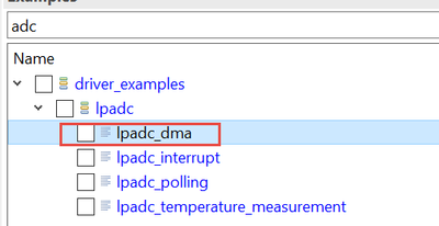

Hello @jwp1
There is ADC+DMA demo under SDK, you can have a look:
Alice
