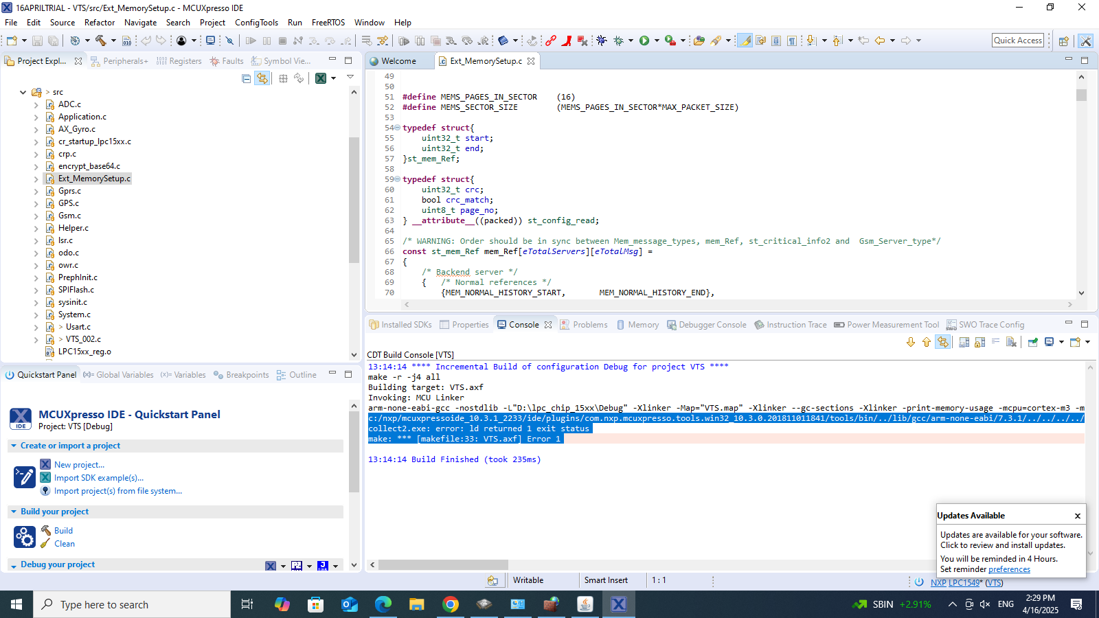

cannot find -llpc_chip_15xx
4,368 Views
Trups_123
c:/nxp/mcuxpressoide_10.3.1_2233/ide/plugins/com.nxp.mcuxpresso.tools.win32_10.3.0.201811011841/tools/bin/../lib/gcc/arm-none-eabi/7.3.1/../../../../arm-none-eabi/bin/ld.exe: cannot find -llpc_chip_15xx collect2.exe: error: ld returned 1 exit status make: *** [makefile:33: VTS.axf] Error 1

Trups_123
MCUXpressoID 10.3.1.2233 stilerror for not linking to microcontroller

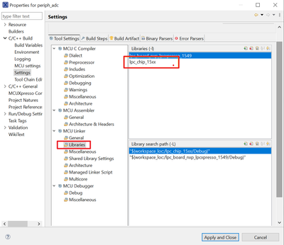

Hello @Trups_123
Please make sure to add the library "lpc_chip_15xx" in the settings. Pay attention not to include "-l" as shown below.

Trups_123
not showing this option and still error is there
