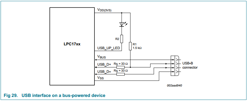

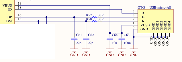

hi
if I connect an usb female connector to pin DP and DM and ID and VBUS, will I be able to read and write into flash memory(usb mass storage drive)?
this below circuit will work alone to read and write to usb flash storage drive?
is it enough?

Hello navid ansari,
   1. USB device hardware, you can use the USB interface on a bus-powered device is enough.
2. About MSD
   You need to download the USB MSD code to the LPC1769 at first, then you can use the MSD function
  Give you a MSD code for your reference. USBMem is the MSD code.
Wish it helps you!
Kerry

Hi navid ansari,
1.if I connect an usb female connector to pin DP and DM and ID and VBUS, will I be able to read and write into flash memory(usb mass storage drive)?
  From the user manual of LPC1768, you can find this chip ISP don't have USB function, so you can't use the USB to read and write the flash memory directly.
  You need to write the USB MSD code to realize the flash read and write function.
  About the code, you can refer to the LPC1768 official code.
2.this below circuit will work alone to read and write to usb flash storage drive?
   This is just the USB hardware interface, the MSD function you need to download the code to the chip.
Kerry

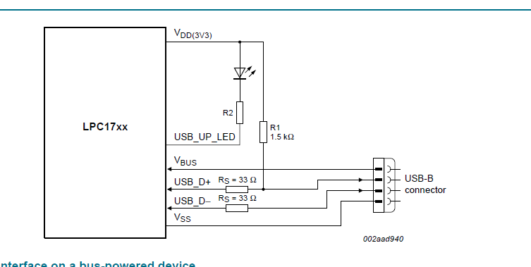

should i use this Fig30?
or this Fig29?
for reading and writing to USB MASS STORAGE DEVICE?
I'm asking about hardware design of it
i think my q is so clear and either this or that for reading and writing to MSD(Mass Storage Device)
please someone help me

navidansari
u say add USB MSD code to LPC1768. I didn't get it what u mean
please help . where is this USB MSD code that u say i should download to lpc1768?
how to download  it to lpc1768?with keil?should i change memory aria in keil?
and how to add USBmem to any keil project?should i add whole library in that folder to project?
where should i read this stuff to work with usb mass storage?
thanks allot

navidansari
I didn't get it . so schematic is not enough to read and write to MSD?
or i should have this schematic and download code for MSD to LPC1768 to be able to write and read to MSD?
if not,  what should I add to the schematic?
