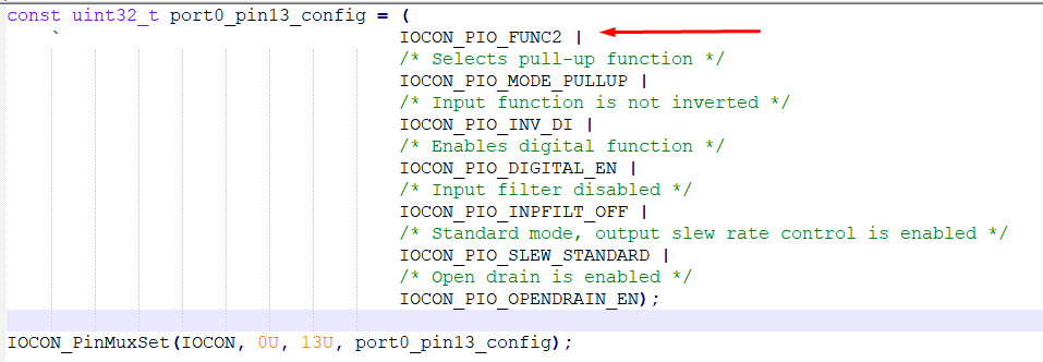

I am trying to interface to a gps module using i2c :
https://www.u-blox.com/sites/default/files/NEO-M8-FW3_DataSheet_%28UBX-15031086%29.pdf
(interface packaged i am using ) neoPLC GPS - High Speed, High Precision GPS for Arduino — neoPLC
I want the LPC to be the master and the gps to be the slave. (using polling)
I can't seem to get it to work following and modifying any of the i2c examples from the sdk.
I have configured the pins i am using in the pinmux.c file, following the example code:

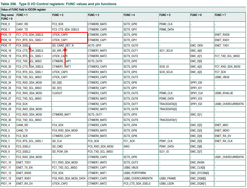

The problem you are having is there. You are using Port0_pin13 and Port0_pin14, in both cases you are selecting the function 2 of each pin, as shown below.
However, if you reference the user manual of the LPC54628 (UM10912.pdf) in page 189 table 256 you will see the different functions for the pins you are using. See image below.
As you can see for  Port0_pin13 and Port0_pin14 the function 2 isn't for the I2C communication, but the function 1 it is. So it seems that this is the problem you are facing since you are selecting the wrong function for both pins. Your pin configuration should be like this.
