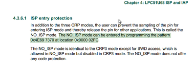

avoiding LPC51U68 enter to ISP mode
2,225 Views
gschelotto
Contributor V
I'm afraid my LPC51U68 is entering to ISP mode and I see in the UM the next statement:
How can I do this?
regards,
gaston
2,215 Views
ZhangJennie
What specific problem do you have?
Can you access debug via SWD?
Can your board enter ISP mode?
Did you set CRP in source code?
Jun Zhang
2,188 Views
gschelotto
Contributor V
Pin2 (PIO0_24) is stuck at 0V after reset and I cannot toggle this digital output to high.
Yes, there is no problem with this.
I would say no since PI00_31 = 3.3V at Power Up through a 47k pull-up .
No
regards,
gaston
