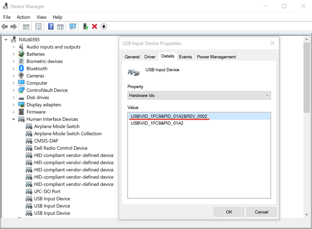

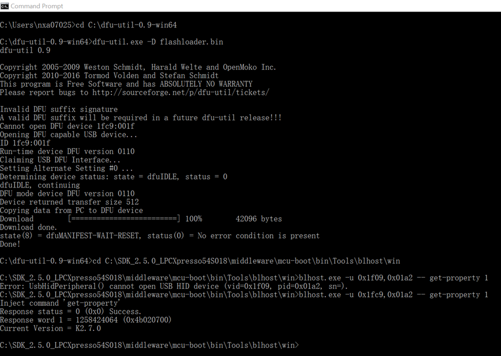

Hi Oscar Niño,
Thanks for your reply
It seems a bit weird, today I do another testing on the Win10 64 bit and the testing process is as same as you described, however, it still doesn't encounter the similar you mentioned before.
Fig 1
Fig 2
