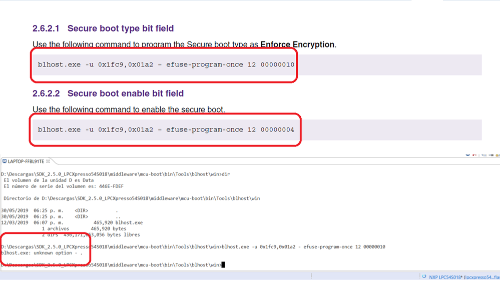

oscarniño
Hi jeremyzhou

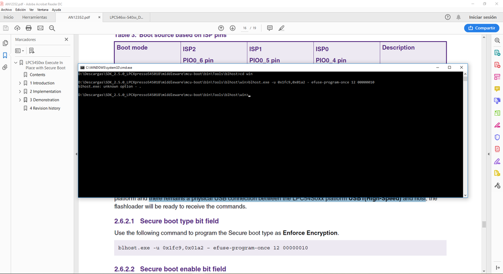

Well I got some issues that doesn´t let me follow is this
The command above has a "-" between last hex number and efuse which show up "unkown option -"
 Any idea why?
Which usb connecto will be connected to evaluate result with terminal? and how to connect that terminal? It is posible from tab Terminal in MCU? and how?
Attach Bin files Original, splited images and secure image with key by elftosb-gui and key.
One doubt else:
Can I crearte manually the key array? for example:
"oscarninogarcia1"
0x6f, 0x73, 0x63, 0x61, 0x72, 0x6e, 0x69, 0x6e, 0x6f, 0x67, 0x61, 0x72, 0x63, 0x69  0x61, 0x31
10,208 Views

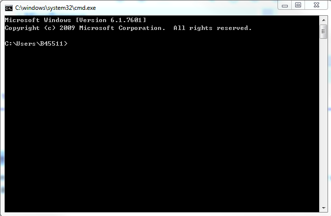

jeremyzhou
Hi Oscar Niño,
Thanks for your reply.
Q1) In 2.6 Program the related OTP bit fields to enable secure boot section of AN12352, it only illustrates the command, however, it forgets to notify that these commands should be inputted in the CMD window, so please give a try again.
Q2) Can I create manually the key array?
-- Yes.
TIC

jeremyzhou
Hi Oscar Niño,
It should follow the below format to input the efuse-program-once command, actually, it needs two '-' between the blhost.exe and efuse-program-once.
blhost.exe -- efuse-program-once  <addr> <data>
TIC

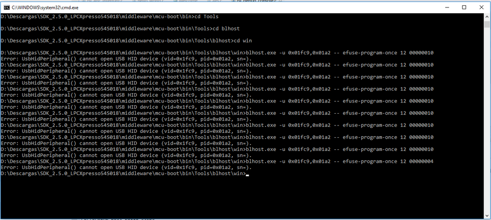

oscarniño
Hi jeremyzhou
I still have trouble. Using that function this is the result
10,208 Views
jeremyzhou
Hi Oscar Niño,

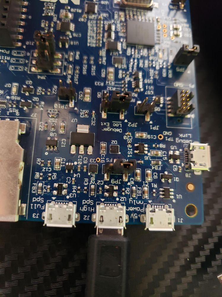

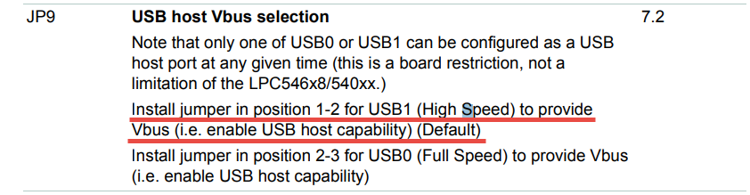

According to the error message, the PC host hasn't recognized the USB1, it may be caused by the below reasons.
Before connecting the LPC54S0xx platform USB1, it should install a jumper in position 1-2 of JP9.
In further, after connecting the USB1,  please check the Device Manager to confirm whether the PC has recognized the new HID class device.
TIC

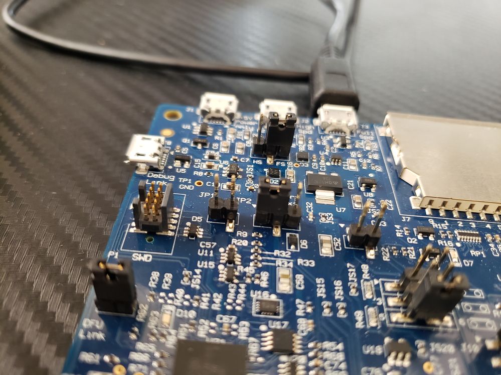

oscarniño
Hi Jeremyzhou
Maybe if I show you how I did it, you could find my error:
After split images and precessed the secure one, this is the flasher process.
Then build and compile the AES
and then updating by DFU tool
here is the error that I get
Well now this is how the board was connected for each case:
To download and flash secure and non-secure part and AES this was the connection
to flashloader
before this connection ISP0 and ISP2 were pressed to enter in DFU mode as AN12352 indicates.
And finally to Send commands it was the connection.
do you know what I'm doing in the wrong way?
Best Regards
10,208 Views
jeremyzhou
Hi Oscar Niño,
The videos are unavailable, please check it.
I'd like to point out that when unplugging the USB0 to plug the USB1, the board should be constantly powered, so I think you should keep a USB cable to plug the J8 to supply the board.
TIC
10,208 Views
oscarniño
Hi Jeremyzhou
Ok I have atteched those videos on zip file. I have tried you seggestion but the problem is still happened. I tried with J8 connector and with 5V Power Only connector but error is still happening.
Beast regards
Oscar Niño

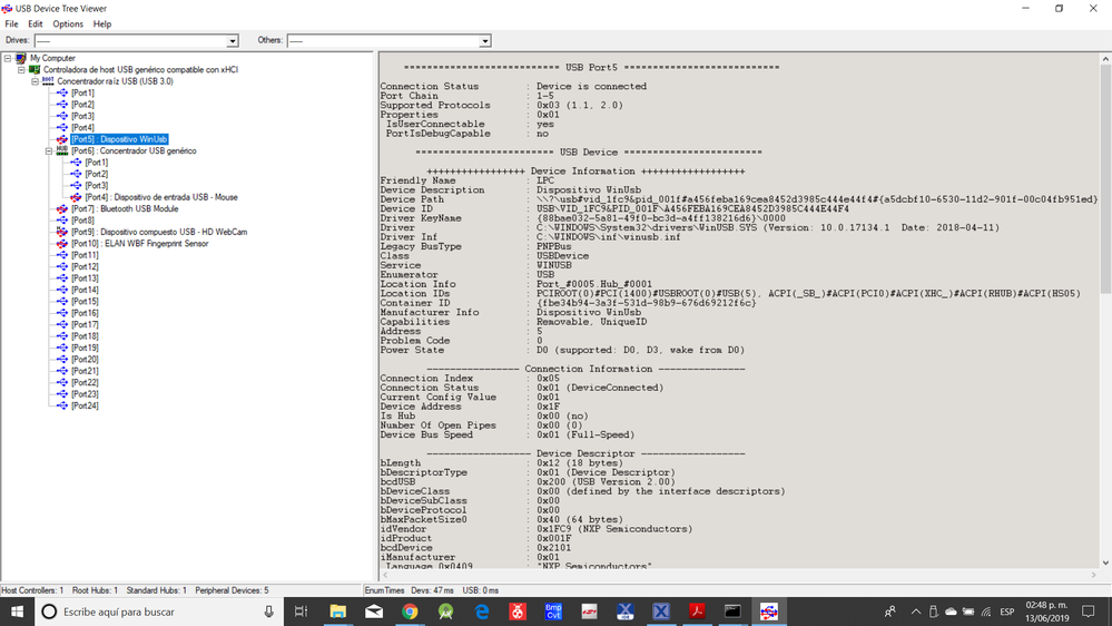

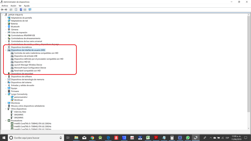

oscarniño
Hi jeremyzhou
Thanks for reply. How it could showed or be configurated? Where can I find that device? I mean where can I check those VID and PID?
Best Regards
10,208 Views

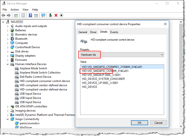

jeremyzhou
Hi Oscar Niño,
Please check the VID and PID as Fig 1 demonstrates.
Fig 1
TIC
10,208 Views
oscarniño
Hi jeremyzhou
Thanks for reply. I don´t get that HID device active. I think it could translate "dispositivo definido por usuario compatible con HID" (HID-compliant consumer control device). Any suggestions? I'm using windows 10 this, could be the problem?
Best Regards
10,208 Views

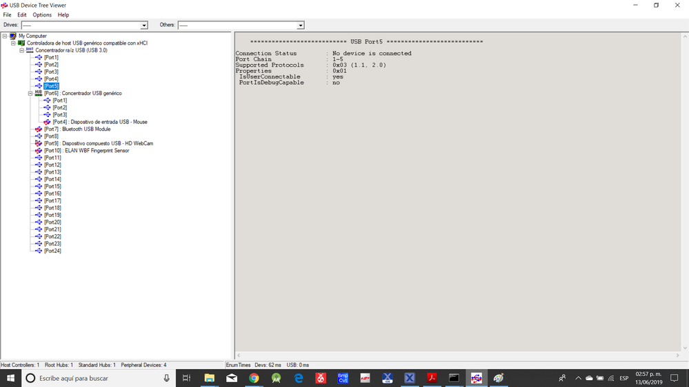

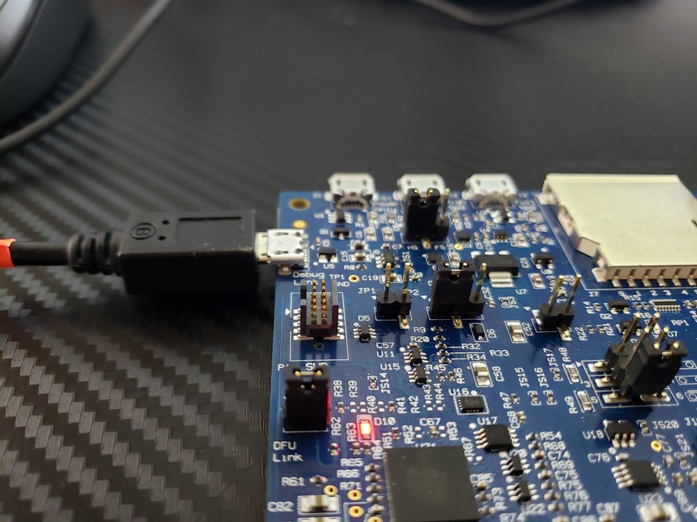

oscarniño
Hi jeremyzhou
Thanks for reply, I have check this option but I still can't see that device, I was checking when desconnect every usb from LPCXpresso54S018 and PC, when USB DFU is connected there is information about usb port:
 but the connect J8 connector(debug) to keep powered the board and after download flashloader, disconnect USB DFU(J3) and jumper J9 (set in FS), then after connect High Speed (J2) Connect J9 to HS position and then connect USB HS(J2). but non information is showed:
Thanks for your time.
