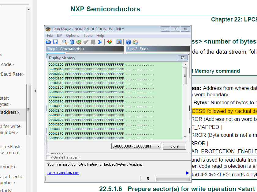

Hi torukoyama,
   Please check my test result with lpc812max board.
1. Use the flash magic read out the 0x3800 address data:
All the data in 0X3800,0X3804,0X3808,0X380C is 0xffffffff.
Please check my ISP mode command:
0X52 0X20 0X31 0X34 0X33 0X34 0X34 0X0D 0X0A 0X30 0X0D 0X0A 0XFF 0XFF 0XFF 0XFF
It is:R 0 14344<cr><lf>0<cr><lf> 0xffffffff
14344: 0x3800
0:CMD_SUCCESS
0xffffffff: actuall data plain binary
You can find, 14344 is address 0x3808, the read out data is 0xffffffff, the same as the result from the flashmagic.
My chip is also LPC812M101JDH20.The revision identifier is 4C.
Wish it helps you!
Kerry
