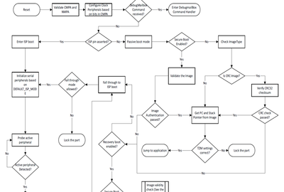

In UM11126, it says about Secure_FW_version in CFPA page just used during SB2 file loading. I am going to write a secondary bootloader that uses this monotonic counter for preventing roll-back. Now I am afraid that after altering this counter, my bootloader will not be able to boot up because of the version check when bootrom boots to my bootloader. If it checks the counter, may I use the NS_FW_version counter for my anti roll-back mechanism?
Thanks.

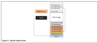

According to the AN12283,the signed image inside the internal flash is like
that includes header, which includes version number.
In the UM11126, the manual states it just uses for during SB2 file loading.
I am working on a project that act as a secondary bootloader. I want to use the Secure_FW_version or NS_FW_Version as a monotonic counter for version checking because I don't want to waste flash size to make another CFPA-like page. I can't find the detail about how the image being validated during boot. Will it compare the image header's version number with the CFPA version number? Or it just validate the signature of the header?
