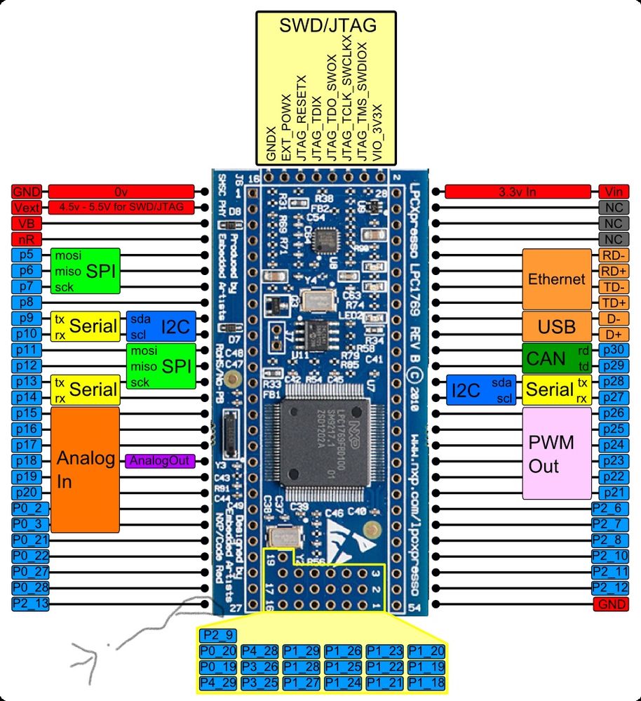

Im using lpc xpresso 1769, and the pin with the interrupt is on the pin of the image.
I Run the code a couple of times, what the interrupt does is change the value of a boolean to execute a sum or subtraction; but after a while it stopped working.
The interrupt is a push button NA.
Thanks in advance.

Hello!
I highly recommend you to use the examples provided in the LPCOpen as a guide to see how to make the configurations for a pin interrupt. The example that suits your needs is the periph_pinint, here you will see the configurations that are made to declare a GPIO pin as an interrupt.
If you are using MCUXpresso IDE then you will find the LPCOpen package in the next path:
  • C:\nxp\MCUXpressoIDE_10.1.1_606\ide\Examples\LPCOpen\lpcopen_2_10_lpcxpresso_nxp_lpcxpresso_1769.zip
Hope it helps!
Victor.
