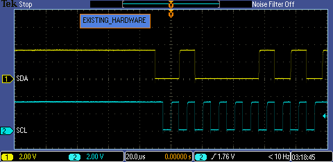

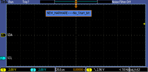

Attached are scope screenshots for existing hardware and new hardware.
With existing hardware, slave sends an ACK.
With new hardware, after START condition is transmitted, master fires an interrupt to inform software that START bit has been transmitted but I don't see it on SDA line.  I'm triggering on START bit.  What might be the problem?
Some inputs in the I2C expander chip are floating.  Is this preventing the START bit to appear on the SDA line?
From I2C expander datasheet:  "External resistors are required for inputs (on P Port) that may float.  Also, internal pull-up or pull-down may be used to eliminate the need for external components."

Problem Solved:
First new board:  saw NAK in software
Second new board:  SCL and SDA no wiggling at all
Third and Fourth Board:  I2C communication working as expected
