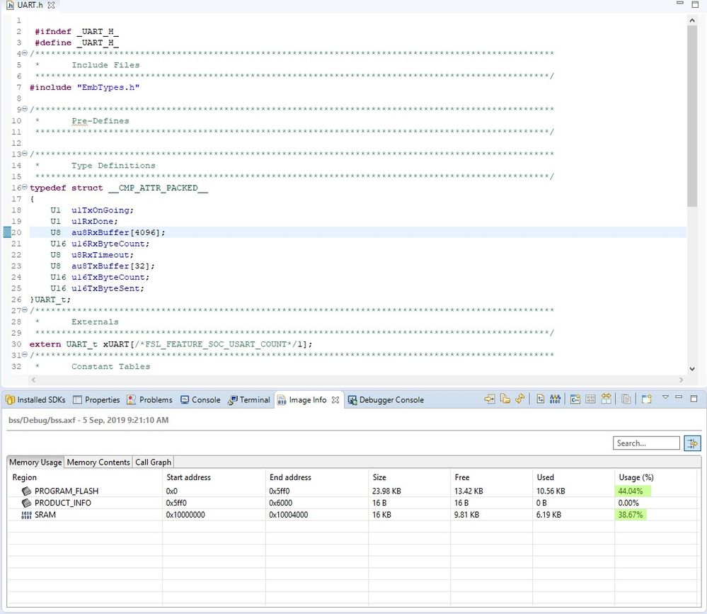

I observed that when I'm increase or decrease variable array size, flash size is also change.
I have seen in Flash Memory contents it shows .bss section which occupy considerable amount of Flash why .bss section comes in Flash?? It should be there in RAM section only.
I have even check linker setting in project setting but no option available?
I wonder why .bss section is mapped in SRAM and how to change it?

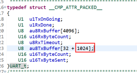

Please check workspace..
Go to UART.h file and change buffer value.

Then, I increased txBuffer as you suggested:
And I got the results below:

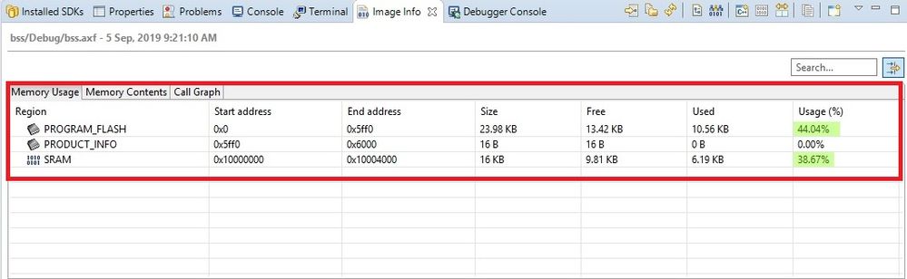

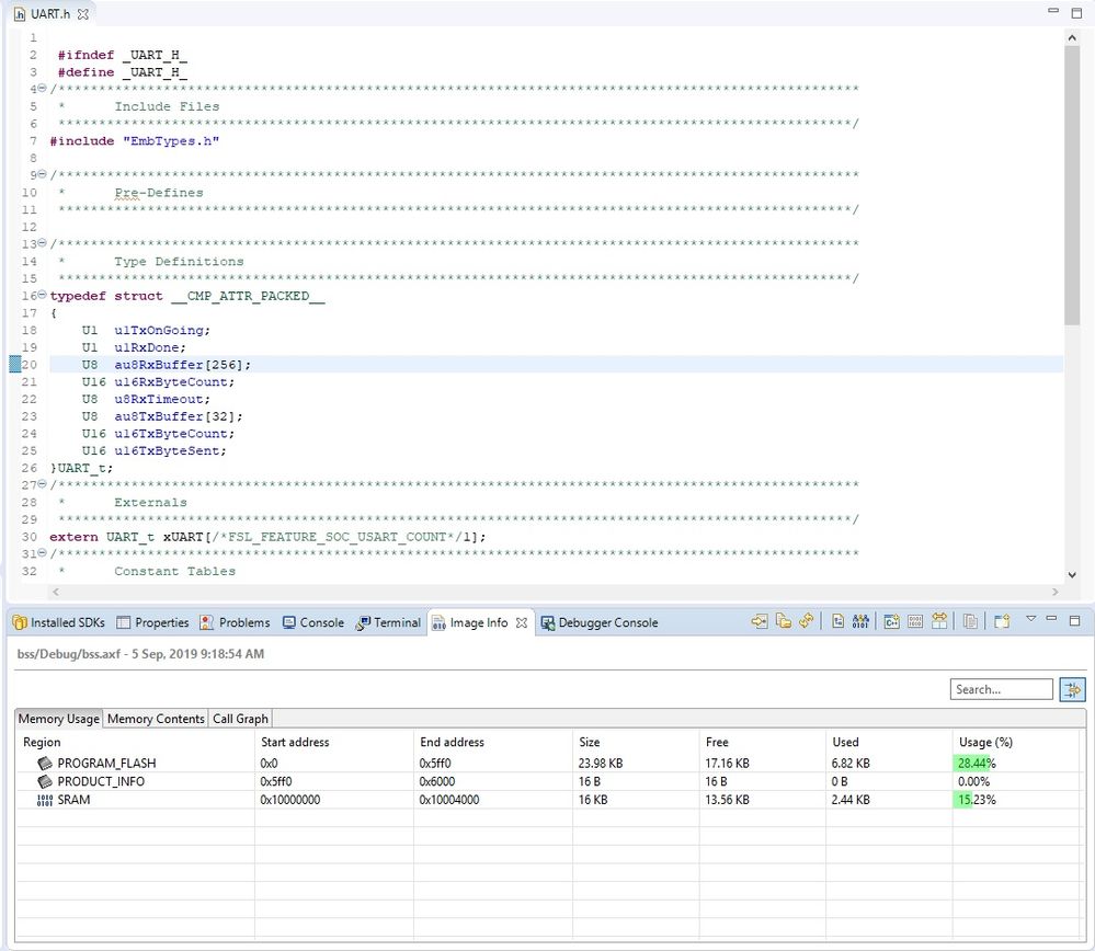

As i told in earlier post, Console shows correct value but Image Info shows wrong value. Please compare below images with different buffer size.
With 256:
with 4096:
Hope above image is enough to describe my issue.

Comparing the numbers shown in the Image Info view - I DO see your problem. This looks like a bug in the ImageInfo viewer @NXP - can somebody look into this?

As I said in earlier post In console tab everything is OK only issue is in Image Info tab.
compare Usage (%) in previous post where i have shown you with memory usage with different buffer size.
Region PROGRAM_FLASH should not change if i change buffer value.

FelipeGarcia
It seems that the image info data is incorrect. I recommend you to see the console instead we will fix this in the next release.
Felipe
