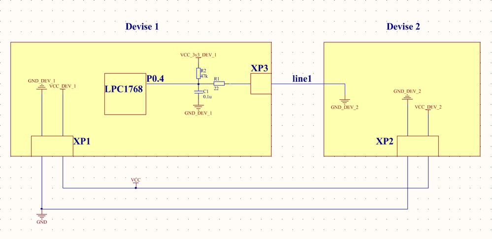

I have a problem.
I have two devices, as shown in the figure.
I do the following:
1. I connect the power of device 2 through the connector xp2
2. I connect line1 of device 2 to devise 1 through the connector xp3
3. I connect the power connector and ground connector to xp1
4. and lpc1768 do not run!!!
What is this magic? Why lpc1768 do not run? What I missing?

P2.10 at high , controllet not at a boot state.
Its a valid user program .
If we сhange the sequence to:
2. I connect the power connector and ground connector to xp1
3. I connect line1 of device 2 to devise 1 through the connector xp3
4. and lpc1768 work fine

Is P2.10 high at boot? (otherwise the chip is in programming mode) and is there a valid user program with correct checksum in the controller?
