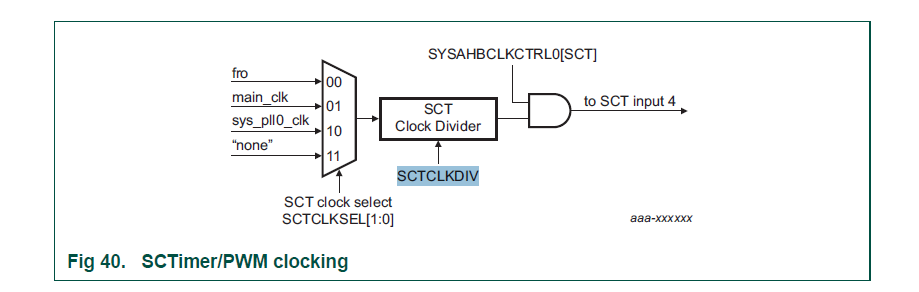

Hi, Angiey,
From theory, the SCTimer is a clock divider, if you use 30MHz system clock, and set the UNIFY bit in SCTimer/PWM configuration register, the counter is 32bits counter, the divider is 2**32, you can get at least 30MHz/(2**32) =0.007Hz signal. So it is okay to get 0.5HZ signal if you set the match register as 60 000 000.
As an alternative, you can use input 4 as the SCTimer clock signal, which can be 12MHz FRO, but you have to use 32bits counter by setting the UNIFY bit in SCTimer/PWM configuration register.
Hope it can help you
XiangJun rong

xiangjun_rong
The PWM code in SDK is complicated, I develop an example code for the 0.5HZ PWM signal, it is okay when I run it on LPC54114. You have to modify the code yourself based on your application.
Xiangjun Rong
