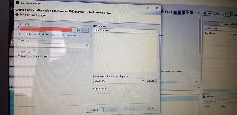

vidhya1
Good Day!!
After opening MCUXpresso Config Tools--
I clicked on --> Create a new configuration based on an SDK example or hello world project--->next
and the image which I attached is opened with" SDK PATH IS NOT ASSIGNED],
I have downloaded SDK example but not able to copy and install in the SDK directory, please suggest
to resolve this,  I have attached the image of the same.[1st image SDK PATH IS NOT ASSIGNED]

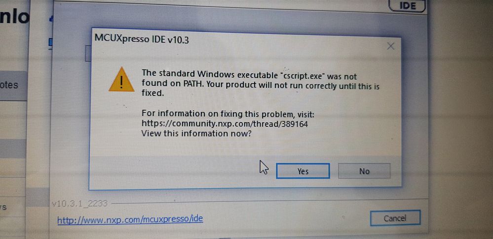

Also before installing MCUXpresso IDE, I got the error regarding to path issue, I have attached the image
of the same[2nd image], even though the sample code is compiling now , while code is dumping to the development board ,I will be getting some errors, I'll just click ok to dump the code.SDK path is not assigned.jpgpath not found error.jpg
